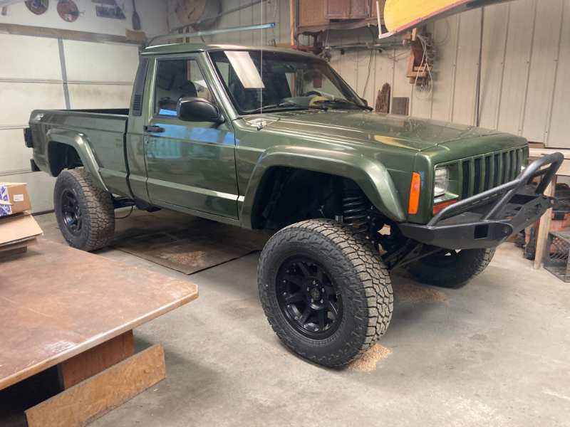

Tried on a set of Icon wheels with some 31s for kicks and giggles. Also picked up a JCR winch bumper off of marketplace.
Next the rear bumper and bed will be bedlined.

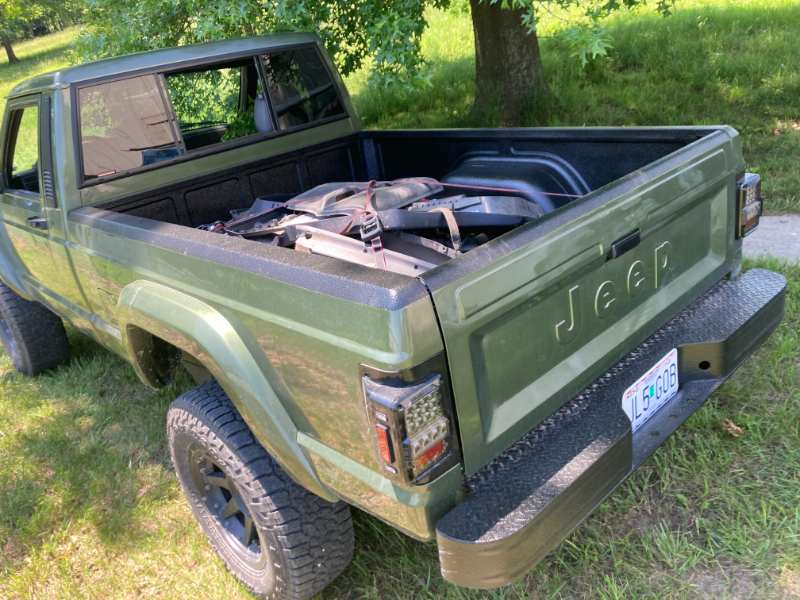

I gave the bedliner from RE paint supply a shot. turned out very nice!
Also a thanks to my brother who plastic printed up a new set of tailgate alignment wedges, the tailgate closes nice and straight.
Will note I'm not a total fan of the JK taillight adapters that came with the truck, Looks like a rushed print job. had to glue them back together several times.
For what it is, if I were to do JK lights, I'd build a metal version.

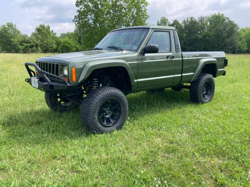

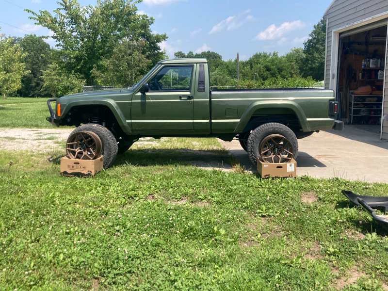

Now for a update pic, threw on some 31s to take it to get inspected. Boy do they look small with 7" of lift and notch flares.

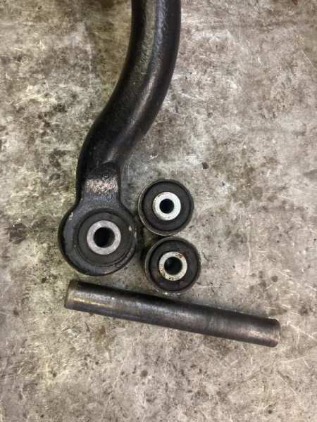

Well it's true, The bushings on the rough country track bar are good for about 500 miles. You can see how they have deformed.
Changed them out for Moog 7252 bushings on both ends with 9/16" bolts.
Do recommend doing this to the RC track bar, Did help tighten up the steering.

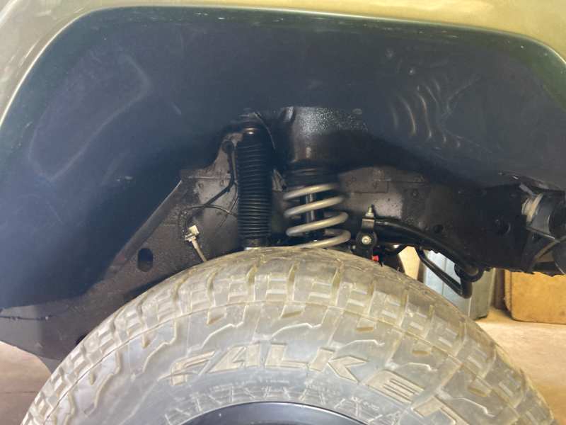

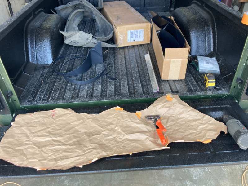

Borrowed from A-man930 with his wheelwell liner idea. Picked up a roll of .070" plastic from Summit Racing.
Part number is AAF-ALL22400 for those who are wondering.
Little bit of CAD drawing with some paper, some heat gun action to bend it similar to the stock liner and just like that, one clean looking wheelwell.
Looks great! I'm betting the CAD made the fit up easier

Sure thing A-man930, simple way to get it right the first try.

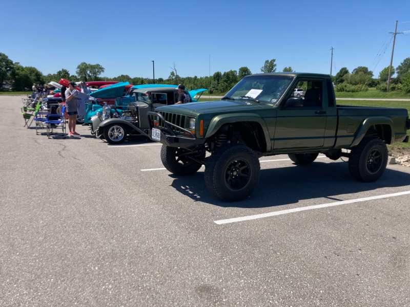

Brought the MJ to a car show. Good collection of hot rods and bikes there.
Funny story, Had a kid walk up to the front bumper and do some chin ups. Guess JCR was right, It's built for whatever.

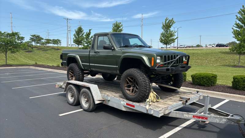

I just have to ask, are you planning to stick with that tire size and lift? That’s a massive front wheel arch gap you have there :holdwrench:. Or do you need that amount of wheel travel?
1 hour ago, grainofsalt said:
ghetdjc320, There are some changes coming to how it sits.
No, Don't need that much wheel travel. Still doing shakedown on it, So far it's been doing real good.:L:
Sounds good :L:. Great color choice with the paint/rims combo. Truck looks great, just hadn't seen that much wheel arch opening as a final product and wondering if there were some plans in the works. Out of curiosity, how much space is there from the top of the tire to the bottom of there flare?
