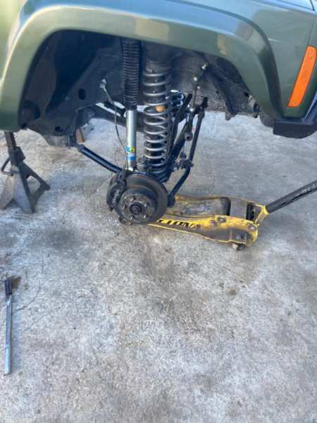

grainofsalt Posted June 7, 2025 Author Posted June 7, 2025 These Rock Trix rims are about 8 Lbs. lighter than the icon rebound Rims. There was a noticeable difference in getup and go with them. Gears happening next, Muds and 3.55 gears equal about 12mpg. With the 31s and 32s it was getting 14.5mpg.

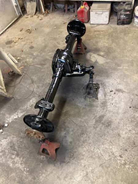

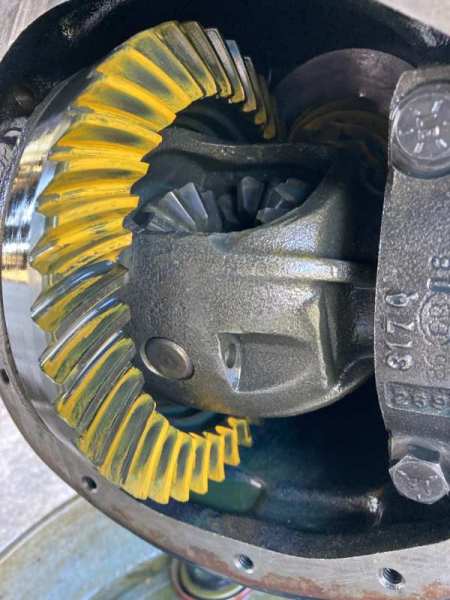

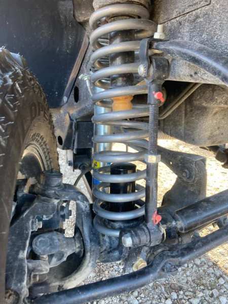

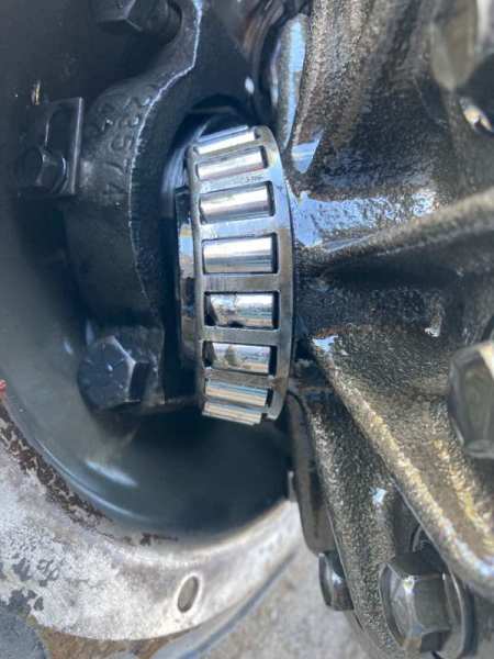

grainofsalt Posted June 20, 2025 Author Posted June 20, 2025 Found out why the rear was so noisy, Bearings were roached! Dropped to 4.88 gears, It's got room for 37s so wanted to leave the future option open.

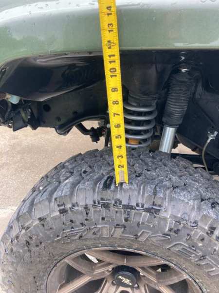

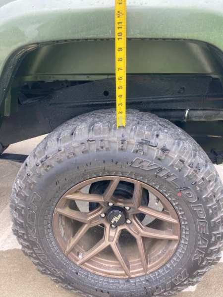

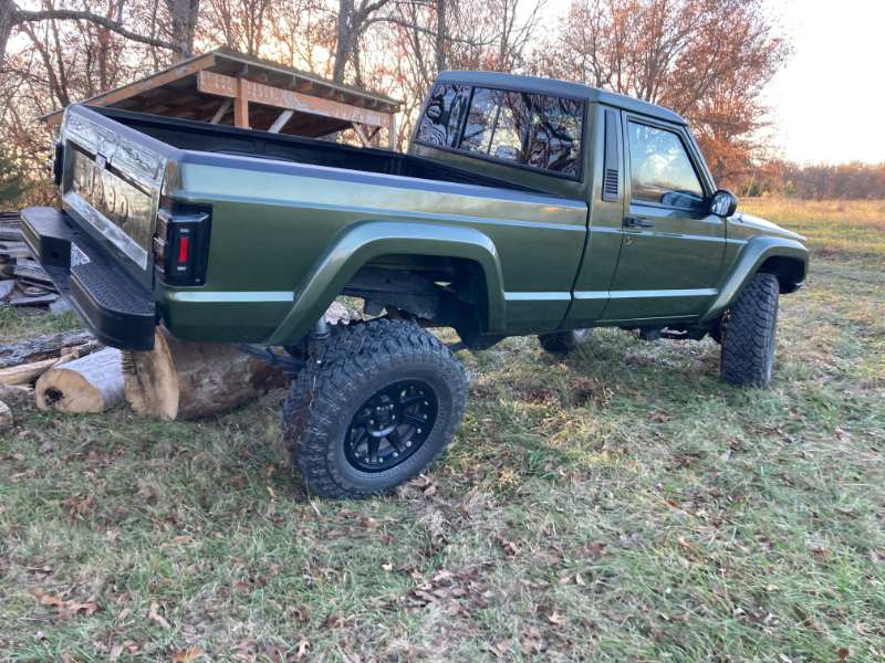

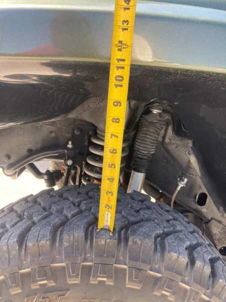

grainofsalt Posted June 21, 2025 Author Posted June 21, 2025 Posting these out of order, but flexed the MJ a little to measure for bumpstops.

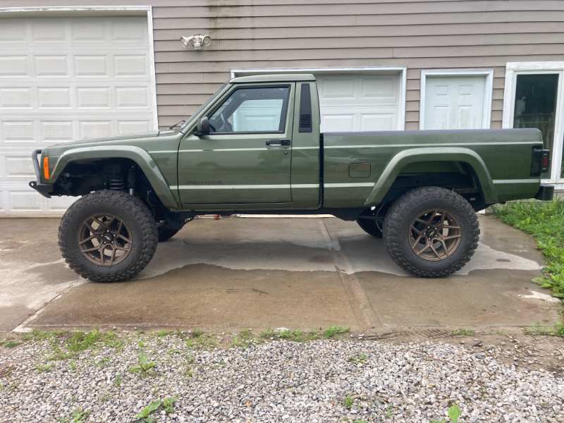

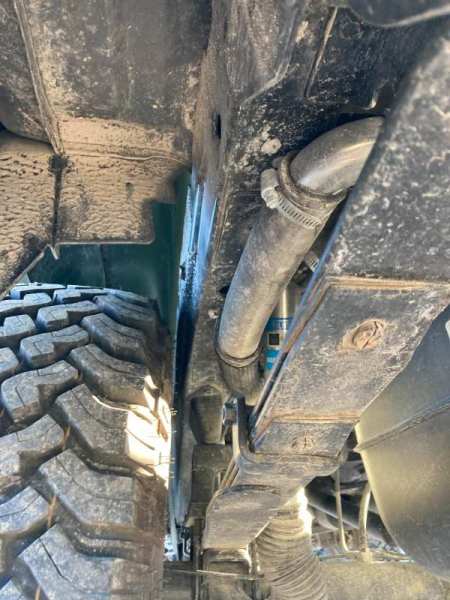

grainofsalt Posted June 25, 2025 Author Posted June 25, 2025 Small update, Pulled the extra spring rubber out to give the truck a little bit of rake to it.

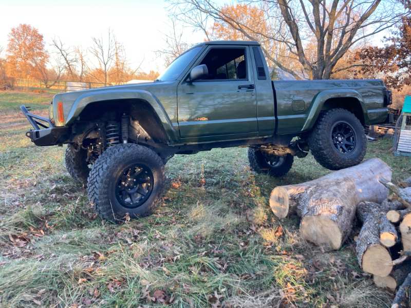

grainofsalt Posted July 5, 2025 Author Posted July 5, 2025 Well, this is cool, My MJ is the MJ of the month: https://comancheclub.com/topic/74908-july-2025-a-2000-swapped-shortbed/

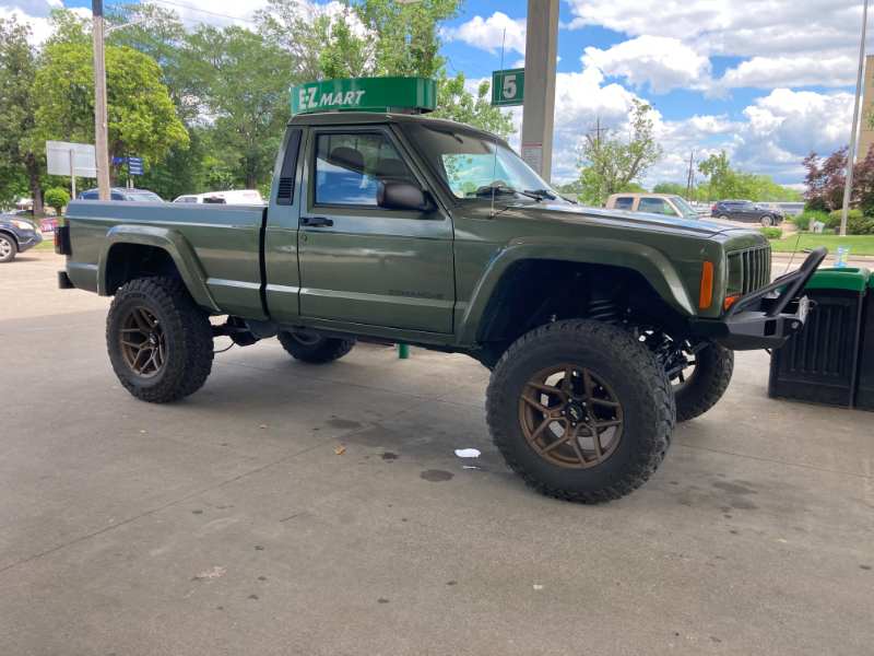

grainofsalt Posted July 26, 2025 Author Posted July 26, 2025 Took the truck on a 1000 mile roadtrip. It did good, running 65-70 with cruse on it did 16 MPG.
