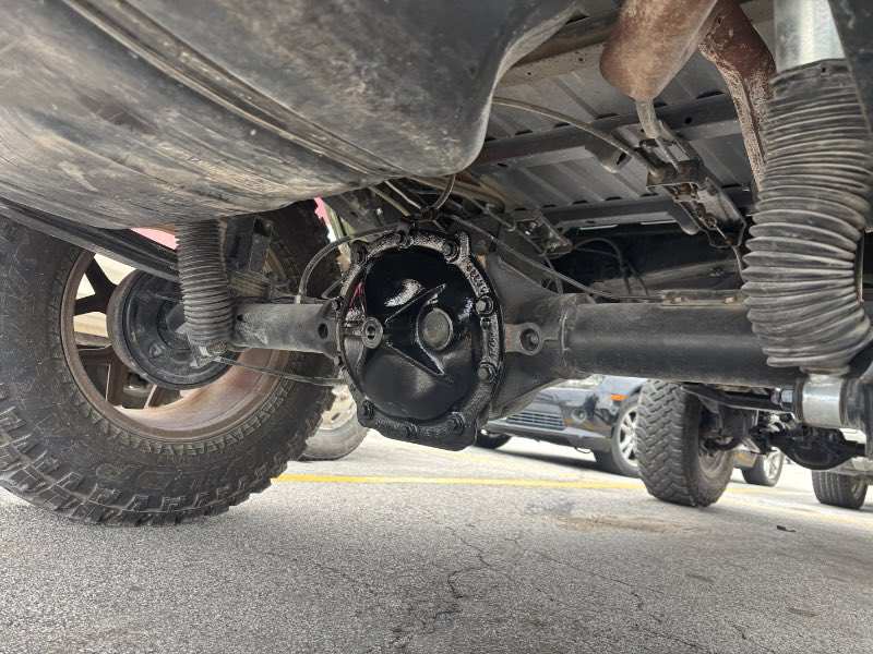

Small upgrade this weekend: Put a diff cover on from a 2004-2009 Dodge Durango or Chrysler Aspen 8.25. Some came with the 9.5 axle so count the cover bolts; 12 bolt is the 9.5 the 10 bolt is a 8.25. To pull one of these you’ll need a 21mm for the Watts linkage bolt and a 13mm for the cover bolts. Take the mounting bolts, They are longer than the XJ 8.25 cover bolts. Pull the two alignment dowels out of the backside and you’re good to go. It’s a nice little budget upgrade. It also puts the fill hole about an inch higher. -
