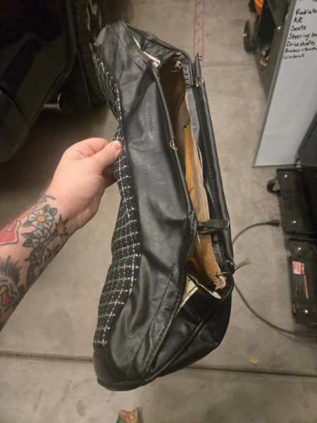

damianriel Posted May 23 Author Share Posted May 23 6 hours ago, fiatslug87 said: Nothing was cut. Are you sure? The Velcro portions on the covers are vastly different on the black vs the burgundy that came on the seats. I'll go take pictures in a minute. Link to comment Share on other sites More sharing options...

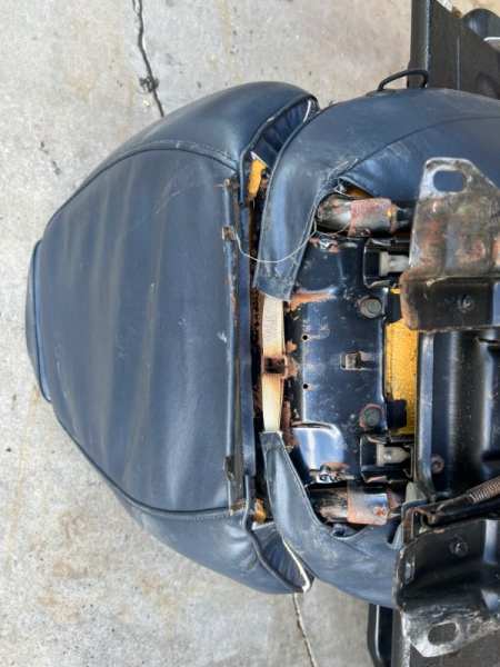

damianriel Posted May 24 Author Share Posted May 24 @fiatslug87 The Velcro portions on the bolsters exist in the exact same spot the hinge mechanism exists in. When I fold the seat down there is a ton of tension as is stretches against this fabric. Link to comment Share on other sites More sharing options...
fiatslug87 Posted May 24 Share Posted May 24 I looked back through your post, you have the seats without the bolsters all of mine are the “wingback” seats. I guess they are different, sorry for the confusion. Link to comment Share on other sites More sharing options...
damianriel Posted May 24 Author Share Posted May 24 5 minutes ago, fiatslug87 said: I looked back through your post, you have the seats without the bolsters all of mine are the “wingback” seats. I guess they are different, sorry for the confusion. I noticed that while I was looking at my seat covers and comparing to the earlier picture you had posted. I did find some local upholstery shops that seem to be pretty highly rated so I may inquire about what they can do. Link to comment Share on other sites More sharing options...

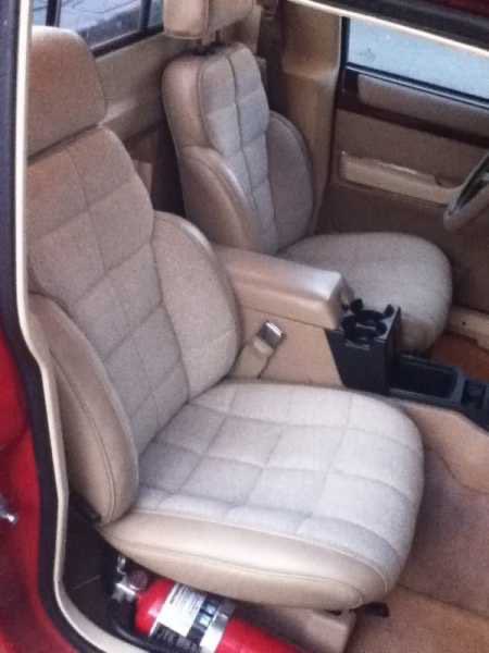

Eagle_SX4 Posted May 24 Share Posted May 24 It is news to me as well that not all covers are interchangeable. I have a set of tan seats that are same as your maroon seats. I also have some 4 door XJ bolstered seats that have the same lower cover design as the folding seats. What year was the XJ you got those black covers from? It may be that early on the folding seats and non folding seats had different covers. Black seats are very rare you will have a very hard time finding another set of covers. That pattern was only used by AMC. Chrysler switched to something else. I would take them and the seat frames to an upholstery shop and see if they can modify them to work correctly. I saw @89 MJ posted recently about some non bolstered navy blue XJ seats. Maybe you could take some pics of those seats and see if they are the same as the black or maroon ones above. Link to comment Share on other sites More sharing options...

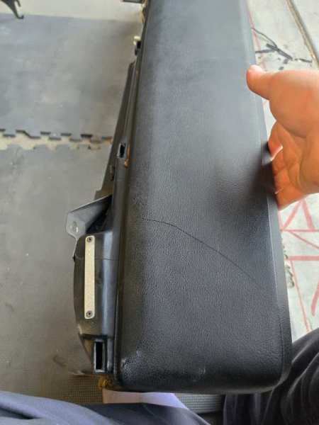

89 MJ Posted May 26 Share Posted May 26 Here’s the best photos I could get without having the adjustment handle. Looks more like the black seat cover. Link to comment Share on other sites More sharing options...
damianriel Posted May 27 Author Share Posted May 27 11 hours ago, 89 MJ said: Here’s the best photos I could get without having the adjustment handle. Looks more like the black seat cover. It appears to me the 4 door seat frames are narrower than the folding frames. I'm not in a rush to get this resolved but it's something I'll have to think about in the future. Link to comment Share on other sites More sharing options...

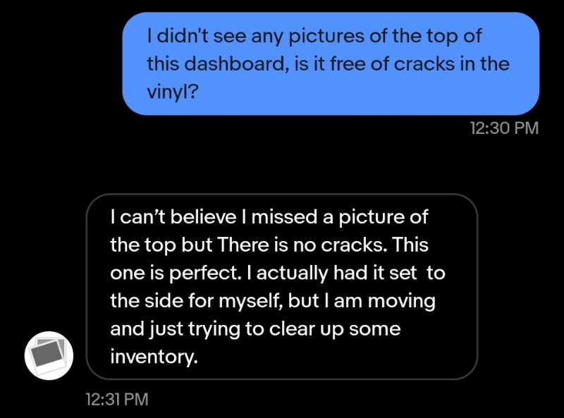

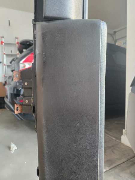

damianriel Posted May 29 Author Share Posted May 29 I'm beginning to believe my quest for a clean black interior is a fools errand. The dash I bought on eBay came in today and to be frank, it's less than stellar. I was under the impression it was in much better condition than it is. It's partially my fault for not seeing that half the mounting screw holes were cracked, and will need plastic weld repair. However I did notice that there wasn't a picture of the top of the dash in the listing. Upon chatting with the seller he assured me it was in good condition and free of cracks, the actual verbiage described it as "perfect" This isn't entirely incorrect however was deceptive, as there is a VERY obvious repair to the vinyl. Now, I still have the dash I bought in 2018, in which the underlying structure is in much better condition, however it appears the vinyl dried and cracked while in storage in RI and I didn't notice until I unpacked it in AZ. I'm thinking I may use the eBay dash temporarily while I look into getting the original dash refinished by either JustDashes.com or possibly a local upholstery shop like @Limeyjeeper had done. I would have liked to keep it OEM but I'm pretty sure I now have over $1200 spent on trying to get a clean dashboard for the truck and I want the next cent I have towards my fools errand to be a well spent one. Link to comment Share on other sites More sharing options...

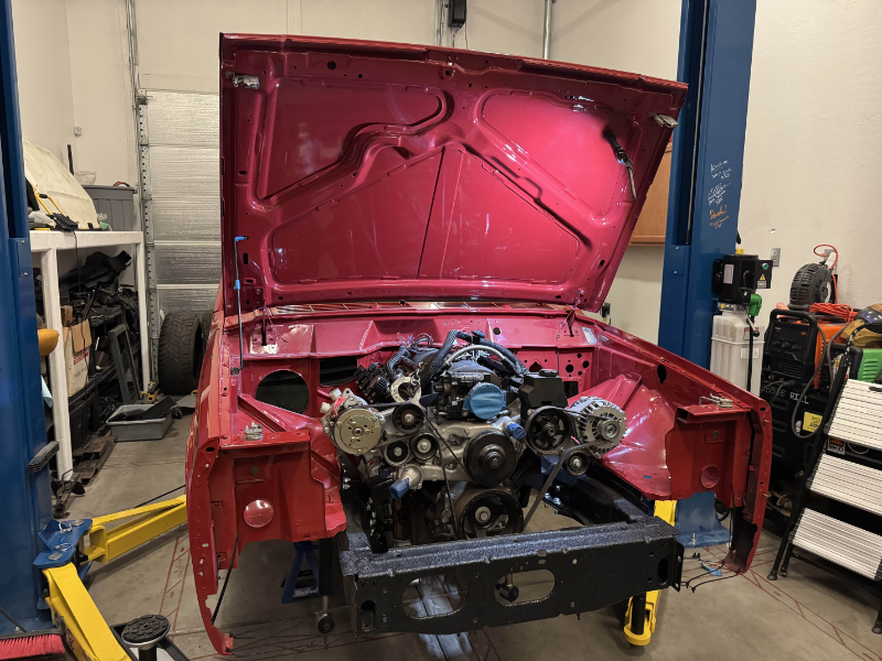

damianriel Posted June 16 Author Share Posted June 16 So, got a little bored this weekend. It's got a long way to go and I'm probably going to change a few things, but she's sitting pretty for now. Link to comment Share on other sites More sharing options...

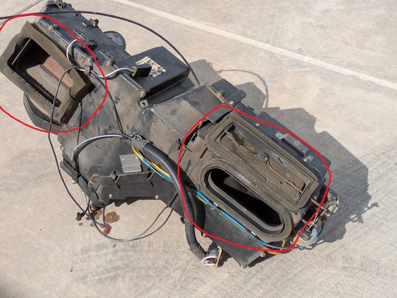

damianriel Posted June 17 Author Share Posted June 17 Tore my 96 Hvac box apart tonight as I don't see a reason to not rebuild it while I have it out. Compiling a list together of parts I'll need and appear to have located copper/brass heater core replacements, likely TSM. I plan on ordering the upgraded evaporator from jeepair, they do have a Heater core listed as in stock as well so I may ring them and see what that's about. Additionally, the hardware that mounts the HVAC box to the firewall, As I have lost or misplaced one. And I'm eyeing this foam to replace the foam on the blend doors. I still need to figure out what foam I'm going to use around the heater core and around some of the vent mating surfaces. I am planning on using this Repop 97-01 kit for the firewall seals, and I suppose I'll let everyone know how that goes. Link to comment Share on other sites More sharing options...
Salvagedcircuit Posted June 23 Share Posted June 23 I ended up using Armacell adhesive backed foam tape for the blend door. It adheres very well and even though I opted to install it on the blend door with the HVAC box in place, it worked well. It also has an anti-mirobial coating on it for what it's worth. It's nice because I was able to get it in 10 minutes and not have to wait a few days for the mail. It's about 1/8in thick. https://www.homedepot.com/p/Armacell-2-in-x-30-ft-R-1-Foam-Insulation-Tape-TAP18230/100539553 Link to comment Share on other sites More sharing options...
