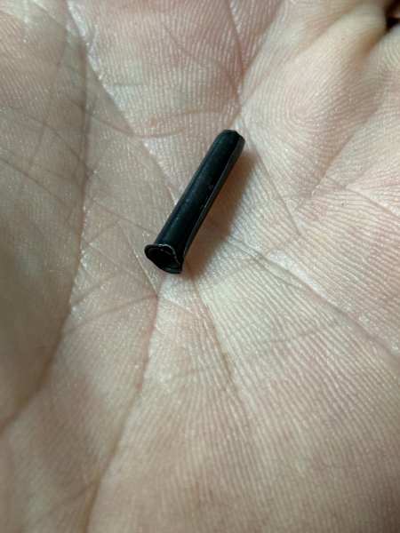

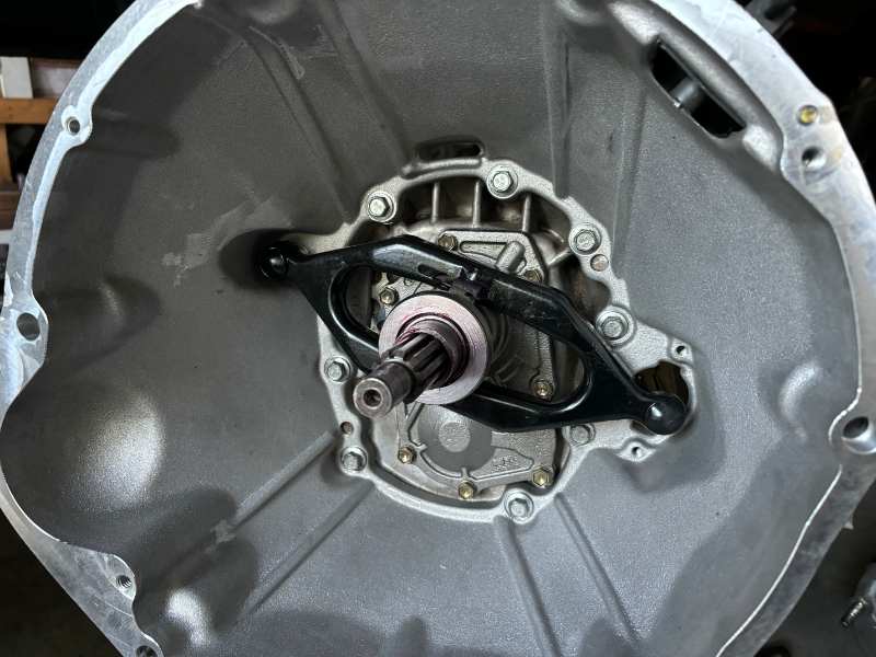

Gojira94 Posted April 12 Author Share Posted April 12 I was just changing out the transfer case front output yoke seal (thought I'd done it but nope) and noticed something just peeking out at the trans inspection cover/ spacer. If you know what this is, you know how I'm feeling right now. I've had it with internal slave. Advance Adapters conversion kit ordered today. After swapping the clutch master with a LuK LM206 shifting into 1st and reverse when warm was a lot better, briefly. Slightly cockeyed slave engagement took that away. At least I know what happened... The level of frustration with not being able to just get out and drive is getting to me. Spent a decent chunk of yesterday doing a blower motor in a Volvo XC70 (ask me how much fun that is). Today was my day to replace the transfer case seal and take it out for some more miles in nice weather. Link to comment Share on other sites More sharing options...
SHAES Farm Posted April 15 Share Posted April 15 On 4/12/2026 at 5:29 PM, Gojira94 said: Advance Adapters conversion kit ordered today. Curious if this is the AX-15 or AX4? Which conversion did you get? Link to comment Share on other sites More sharing options...
Gojira94 Posted April 15 Author Share Posted April 15 3 hours ago, SHAES Farm said: Curious if this is the AX-15 or AX4? Which conversion did you get? Mine is the 89-93 AX-15 internal to external slave conversion behind a 4.0. https://www.advanceadapters.com/4993 My truck did originally have a 2.5 and AX4 but they're long gone. Link to comment Share on other sites More sharing options...

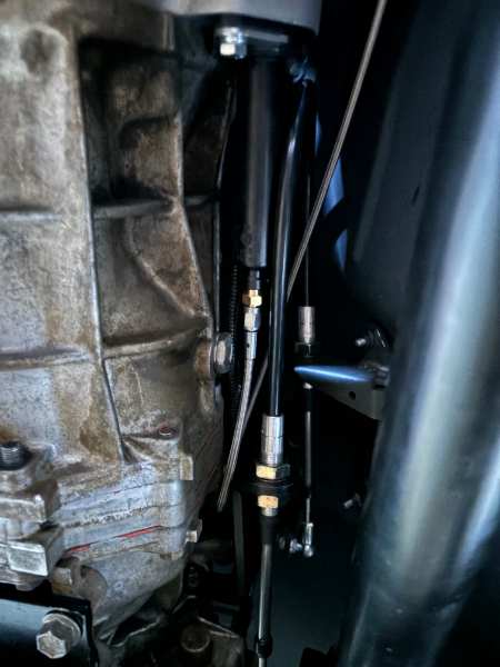

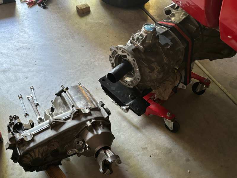

Gojira94 Posted April 19 Author Share Posted April 19 External slave parts showed up Thursday, got a late start yesterday. I ran out of time to reinstall the shafts and bleed it but trans and TC are back in. With a 6" lift, I can roll the trans right out from under on a trans jack. I borrowed this one from a neighbor. He got it at Harbor Freight (Pittsburgh brand scissor style with a strap). Old: New: Important detail for anyone doing this swap - the input shaft cover bolts do need a thread sealer. I've used Permatex 59235 for years on head bolts in water jackets and for stuff like this. Remember to knead the tube really well each time before use! Most parts house stores are only going to have the small tubes (.3 oz) and you'll have to order the big one. Today I'm off to look at a 1972 F350 long chassis with a dump bed/ 390/ NV435, a mid-70s D100 and some other cool stuff, about an hour west of here. Link to comment Share on other sites More sharing options...

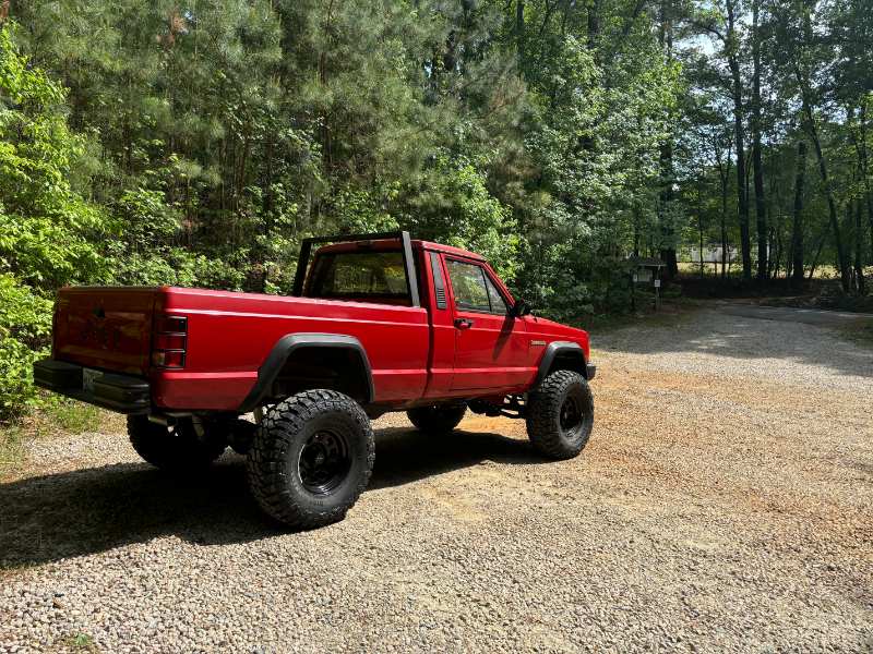

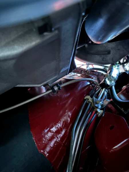

Gojira94 Posted April 23 Author Share Posted April 23 16 hours ago, neohic said: Dang, dude! Can’t believe how clean this truck is. Thanks! There was a lot of sheet metal repair in the area of that 3rd pic, kinda embarrassed, but the rest of the front half I'm happy with, much prettier. I'm looking forward to pulling the bed and rear bumper for a little clean -n- coat back there before I call it really done. Link to comment Share on other sites More sharing options...
