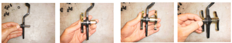

Well not a good post. Jeep took a dump the other day. Not fully sure what happened but it either threw a rocker arm or valve seat dropped. Having it towed back to the guy that rebuilt it and see what he says. I did pick up some of these https://rockerlocks.com/index.html
Guess we will see what happens.

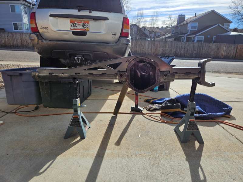

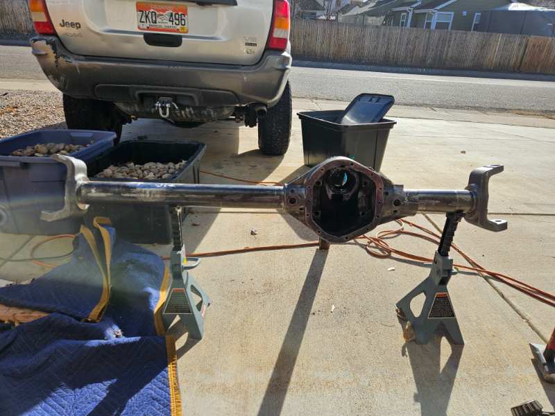

Nothing really new to add other than gathering parts to build version 2.0. So far got trailforged front and rear bumpers. I did get new axles I'll eventually put in. Running a HP44 and 9. Will probably go with 4.56's, zip lockers and 35's. Still need to get stiffners, what ever I plan to do for a suspension, right now leaning towards fabbing links and running TJ metal cloak coils to get about 6.5", and new steering.

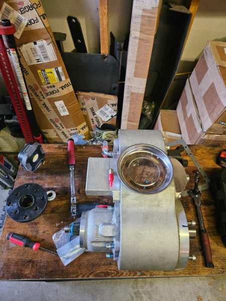

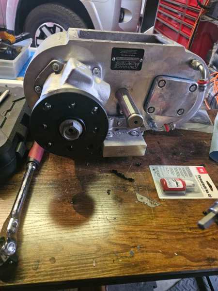

Next up was finally replacing the entire power steering system. The old box was starting to get really sloppy and the pump was on it's way out. Not to mention the leaks from all the old hoses. For the pump I got a new ones from Lares. Ran one in my XJ and never had problems. For the box I went with a redhead.
Steering is drastically improved. Box is nice and tight and turns smooth. No more leaks either so huge win.
