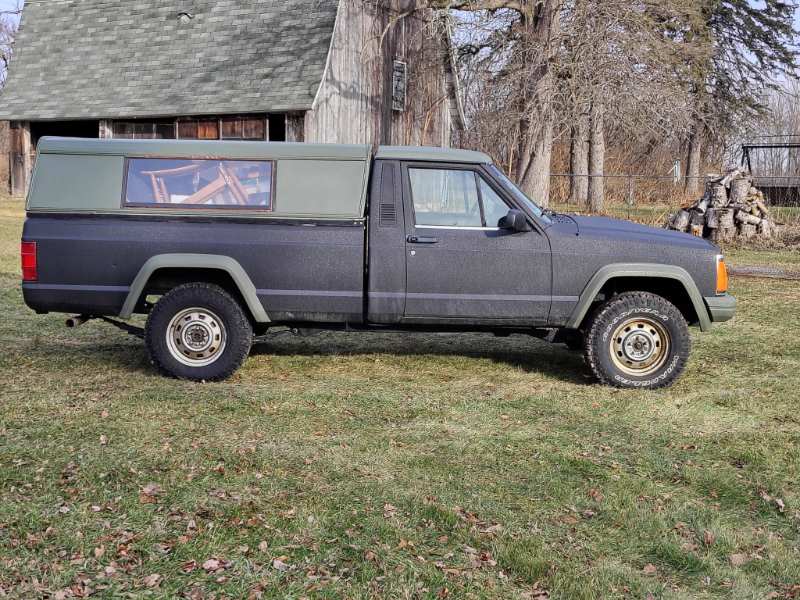

ChainsawCHARL1E Posted Sunday at 07:07 AM Share Posted Sunday at 07:07 AM I just installed the General Springs 1-ton springs plus the Rusty's 0.75" rear shackles to replace the worn out half-ton springs and shackles. It lifted the rear about an inch when unloaded. I also put ZJ springs in front to replace the sagging front axle. The ride is more predictable and the steering more responsive. Link to comment Share on other sites More sharing options...
