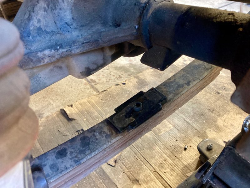

Yesterday I was out having a great afternoon in the woods. Once I got back to pavement there was definitely a new vibration. Shame on me for knowing that the pinion bearing was on its way out but I didn’t expect it to go so fast. Five years ago I knew that the gears themselves were very rough but I just put the cover back on and covered my eyes. It has always made noise but I guess enough is enough.
Going with a TrueTrac limited slip while I’m having it gone through.
posi for the win! :D  hopefully the posi plus all that new engine power don't make it tail happy in the rain.  :driving:
Just got off the phone with the 4x4 shop: "... .130"+ of backlash and a few of the ring gear teeth were missing or chipped."
:laugh: Yup... it was time.
Back on the road! I got the axle back late last week and picked at it a little each day over the weekend. The old carrier had a crack in it so the TrueTrac absolutely made sense to upgrade to.
EDIT: DO NOT USE LIMITED SLIP ADDITIVE!!!
IMG_4932.jpeg.91ffb2678fe030202ac7c6611e3c5709.jpegIMG_4933.jpeg.e9eaaba838867dd3957c002eff3bad85.jpeg
While it was down, I had the driveshaft re tubed. Looking at it now, I need to check my pinion angle. The transfer case got new bearings in the output assembly also.
Everything went back together fine and I put some fresh miles on it today.
