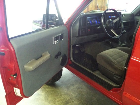

WahooSteeler Posted December 6, 2017 Share Posted December 6, 2017 Has anyone recovered door panels that have the cloth insert running from the door handle across and down behind the arm rest, specifically just the cloth part? I'm getting the seats recovered, actually just the tweed cloth inserts in the middle of the seats, and while the cloth pattern the upholsterer was able to find is pretty close to the OEM tweed, I'd really like to have him do the door panels too for a true match. We looked at the panels (mounted) and the question is, the border/heavy trim where the vinyl on the top and bottom meets the cloth, is that glued on or stitched on or what? Pics attached are not my panels but show what I am talking about. The upholstery guy said he's not sure if he'll be able to put in the new cloth if the border is just glued on. Hoping somebody has dealt with this before.............. Link to comment Share on other sites More sharing options...
fiatslug87 Posted December 6, 2017 Share Posted December 6, 2017 I think it is glued on or plastic welded. Link to comment Share on other sites More sharing options...
WahooSteeler Posted December 6, 2017 Author Share Posted December 6, 2017 That's what we think. It will take more work but I think he may be able to roll the edges up tight to the vinyl trim and just glue and stitch on the new fabric over the old. I may try to find an extra panel for him to experiment on first. Link to comment Share on other sites More sharing options...

WahooSteeler Posted December 23, 2017 Author Share Posted December 23, 2017 Got the truck back yesterday from the upholstery shop. Come to find out the owner is a guy I went to high school with and his real specialty is restoring old British cars, mainly Triumph and Jaguar. He's got a talented crew of 17 people working for him with a 5 year waiting list on restoration projects. Pretty cool, but I digress....... Really happy with how things turned out. New cloth inserts on both seats, replaced torn vinyl and piping in a few places on both seats, new headliner and recovered the visors. I also had the guy install 80 mil sound deadening material on the roof since he had it apart. I was going to put it in myself but he didn't charge me anything to do it since I already had the material. Most importantly, he was able to recover the cloth inserts on the door panels so everything matches. As expected, it would have been a little risky to try to "deconstruct" the sections on the door panels so he installed the new material over the old and did a really good job IMO of rolling the edges up to the vinyl trim edge above and below the cloth part. Link to comment Share on other sites More sharing options...
