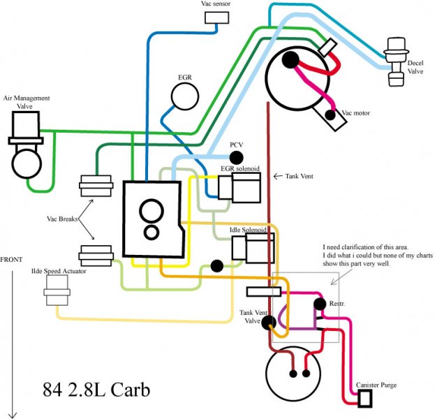

AMC86Kid Posted September 6, 2017 Author Posted September 6, 2017 ok i see so i should get a carb with Vacuum Secondary since they are ideal for street vehicles with automatic transmission and a 2 barrel carb is simple and easy to tune i have found the stamp that verifies its a Rochester Varajet II (i think the 2 stands for 2 barrels) and i am not sure what this stamp is for but i was trying to figure out what exact model it is I found this website and clicked on "CK277" and it looks like the model i have http://www.carbkitsource.com/carbs/tech/Rochester/Varajet.htm Also this looks like an electric choke so does that mean the the current carb is a 2 barrel / electric choke / Vacuum secondary
AMC86Kid Posted September 6, 2017 Author Posted September 6, 2017 Also will this link help me figure out where all the vacuum lines go on the carb http://www.lunghd.com/Tech_Articles/Engine/2_8L.htm
