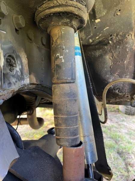

Swampy Posted May 12, 2025 Share Posted May 12, 2025 On 12/18/2017 at 9:58 AM, DesertRat1991 said: I also have the screw in type and need a longer set. Does anyone know if the MJ uses the same OEM scew-in bumpstop as the TJ? If so, these *might* work: 1997-2006 TJ Extended Bumpstop - Daystar Just wanted to update the thread. These do work on the front of an mj. I’ve had them for a bit now but I need to extend them more. Link to comment Share on other sites More sharing options...
ghetdjc320 Posted May 13, 2025 Share Posted May 13, 2025 1 hour ago, Swampy said: Just wanted to update the thread. These do work on the front of an mj. I’ve had them for a bit now but I need to extend them more. The MJ’s I’ve had both had the push in style bump stop that doesn’t have the threaded piece. I’ve use the rubicon express bump stops twice now with good results. If you need a longer bump stop than that, use the puck style spacers on the axle side to take up the space. Link to comment Share on other sites More sharing options...
DesertRat1991 Posted May 13, 2025 Share Posted May 13, 2025 19 hours ago, Swampy said: Just wanted to update the thread. These do work on the front of an mj. I’ve had them for a bit now but I need to extend them more. Glad to hear! Guess I'll update too... my '91 has the removable cups with the threaded stud. I was able to remove the cup, pop out the OEM bump stop and replace it with: Daystar KJ09101BK. Then just screwed the cup back into place. The Daystar bump was actually a little to long for my application but it was easy to cut for a custom fit. Link to comment Share on other sites More sharing options...
