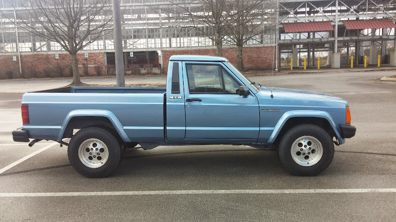

teamsmith Posted February 14, 2015 Share Posted February 14, 2015 My dad and I both agree that we've sunk too much time and money into this truck to give up on it. After 9 months of steady progress, I finally let my dad take it work today to show his friends. On his way home, a minor explosion occured under the hood, resulting in this sizeable hole in the block. Oil and coolant leaked all over the road. Funny thing is that the engine never died, never ticked, knocked, or even showed a high temperature. We towed it back to my house tonight. The question is, do we spend $4k on a Jasper reman, troll some junkyards, maybe get something that's been rebuilt? Should we go HO since we're replacing it anyway? What has been your experiences? If I decide doing the HO swap makes sense, can I take an engine out of a wrangler as well as a Cherokee? Are later years swappable? Here's some pics of the truck; It had been wrecked, 184k miles, sat in a field for 11 years but we got the frame straightened, replaced panels, painted it and breathed life back into it. I was about to put a mild 1" lift on it but that has been put on hold, perhaps indefinitely. I do hate putting good money after bad, but we're too sentimnetal (it was my grandad's truck before he passed) to let it go. I realize this might need to be in Project MJ's but I am seeking techincal advice on an engine replacement and wanting to add context. Link to comment Share on other sites More sharing options...
Mattwheels Posted February 14, 2015 Share Posted February 14, 2015 Thats a Really nice Comanche I must say! The Cheapest option would be to find a low mile used engine, preferably one you can listen to run. if you're looking at spending that kind of money on a Rebuilt I'd almost just look into a Golen stroker motor. Link to comment Share on other sites More sharing options...
teamsmith Posted February 14, 2015 Author Share Posted February 14, 2015 Thats a Really nice Comanche I must say! The Cheapest option would be to find a low mile used engine, preferably one you can listen to run. if you're looking at spending that kind of money on a Rebuilt I'd almost just look into a Golen stroker motor. Thanks. I am proud of how it turned out. My uncle is a painter so we did well to leverage his ability. It looks better after it's been washed and with better light. So, if I go the route of a used engine, can I use any Jeep 4.0? does it have to be from an MJ/XJ, does anything change with the '97+ that would make the engine incompatible? I would also be open to a stroker. I see that Titan has the 4.6 for $2800 but doesn't appear to be turnkey. I'd rather it have the manifold, oil pump/pan, etc. ready to go in. Link to comment Share on other sites More sharing options...
