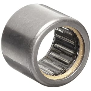

jimoshel Posted January 17, 2014 Share Posted January 17, 2014 Trying to put a 1993 AX15 into a 1990 MJ, 4.0. Hit every parts store in town and could not find a bearing that would work. Got the bearing tool loaner from the parts house and went back to the JY where I got the AX15 from, was going to pull the old bearing and use it. NO luck. It was gone. Bit the bullet and went to the dealership. For $46.94 this is what I got. Yes, I ordered two of them. When I went to try it for fit I found the ID was correct but the OD was a bit loose. Being a 50 mile round trip to the dealer and getting a little annoyed I decided to go with what had. Take a hose clamp, Cut the screw off. Perfect fit. Well, close anyway. Got everything back together and discovered I had 5 speeds in reverse and one speed forward. Crawled underneath and checked. Sure enough I had the tranny in backwards. Trying to make up my mind now whether to reverse the tranny or to move the steering colum to the back of the cab facing to the rear and turn the seat around. Decisions, decisions. :???: :idea: [/url] [/url] EDIT; Done. I'm getting to old for this chet. I can get down and under a Jeep real easy. It's getting back out from under it and back on my feet that's hard. I figure another 15-20 years I'm giving it up. Take up parachute testing or something. Link to comment Share on other sites More sharing options...
HOrnbrod Posted January 17, 2014 Share Posted January 17, 2014 http://www.amazon.com/INA-SCE129P-Bearing-10000rpm-Rotational/dp/B007D42VKS Link to comment Share on other sites More sharing options...

jimoshel Posted January 17, 2014 Author Share Posted January 17, 2014 http://www.amazon.com/INA-SCE129P-Bearing-10000rpm-Rotational/dp/B007D42VKS Now you tell me. Link to comment Share on other sites More sharing options...
jimoshel Posted January 18, 2014 Author Share Posted January 18, 2014 http://www.amazon.com/INA-SCE129P-Bearing-10000rpm-Rotational/dp/B007D42VKS The OD is to small. It's 1 inch. Has to be 1 1/8. Link to comment Share on other sites More sharing options...
HOrnbrod Posted January 18, 2014 Share Posted January 18, 2014 http://www.amazon.com/INA-SCE129P-Bearing-10000rpm-Rotational/dp/B007D42VKS The OD is to small. It's 1 inch. Has to be 1 1/8. No such animal that I can find with that OD and ID. Link to comment Share on other sites More sharing options...

jimoshel Posted January 18, 2014 Author Share Posted January 18, 2014 http://www.amazon.com/INA-SCE129P-Bearing-10000rpm-Rotational/dp/B007D42VKS The OD is to small. It's 1 inch. Has to be 1 1/8. No such animal that I can find with that OD and ID. Me neither. That's why I shimmed it. Link to comment Share on other sites More sharing options...
