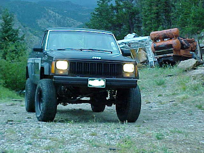

I have read a few other posts about this but it doesn't seem like anyone has a solution to the problem. my truck leans to the driver side about .5-.75". Its an 88, 2wd,4.0,and 5speed. I am working on a 4wd conversion and have installed the front axle with new controll arm bushings, tierod ends, and track bar. It has a new 3" rusty's lift with rear AAL and new shocks. I had the same lean before all the work and was hoping the new front springs would fix it but no luck. I have had the front end alligned and have driven it for several months so the springs have setteled in. I think its the fuel tank dragging it down but didnt know what I could do about it. Has anyone found a soulution?
