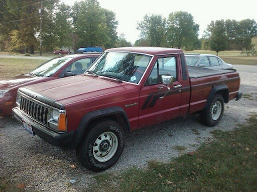

Matt1971 Posted October 8, 2010 Posted October 8, 2010 My "New" 87 MJ 2x4 I6 4.0l 5 speed manual just over 198,000miles. Has some surface rust that is no big deal, only rusted through spots are just over the rear wheel flairs. Engine, floorboards, frame all in great condition. Sorry for the small picture, if you want to see a bettr one you can go to my picasa sitehttp://picasaweb.google.com/matt.newberry/My87MJ#5525495051752186130 until I learn better how to link photos. The lever on the hood release was rusted, that is how I found this site, was looking for how to get the hood open. I have to say this site is awesome you guys have some really good looking trucks. Hope my project turns out to be as nice. If anyone know where I can get a front CCV assembly would be great, mine is cracked, have it "repaired" with tape. No one seems to carry these anymore. Transmission is a bit noisy hoping that changing the tranny oil will help with that. Want to convert it to 4x4, lift it about 3", remove rust and new paint job. It's my DD and want to do light trails and camping on the weekends. Have always wanted a Comanche and finally have one :thumbsup: Hope to post more pics as I start fixing her up.
btm24 Posted October 8, 2010 Posted October 8, 2010 sounds like you got your self a nice mj. welcome :waving: but you have to watch out people love to spend your money :rotfl2: Brandon
cluricaunne Posted October 8, 2010 Posted October 8, 2010 J ust E mpty E very P ocket congrats and good luck on your MJ, looks like a great way to start your new addiction
buxmj Posted October 9, 2010 Posted October 9, 2010 Welcome to the club, hope you enjoy your mj as much as I do.
jimmy21669 Posted October 9, 2010 Posted October 9, 2010 Good find.... Look here for the ccv stuff... http://www.teamcherokee.com/

Pete M Posted October 10, 2010 Posted October 10, 2010 nice looking truck. :thumbsup: the black interior is kinda rare. although I'd keep an eye out for a bench seat with the headrests. more than one of our members have broken the back window with the heads in minor fender benders. if you don't want to mess with the whole bench, the back part unbolts and should be easily interchanged. you might even be able to swap the black cover onto the new back. :thumbsup:
Matt1971 Posted October 10, 2010 Author Posted October 10, 2010 Thanks Pete, wouldn't have thought about the headrest. Will look into it. Not sure if I want to keep the bench or go with buckets, but seeing as the wife is hand making seatcovers for the bench it will stay for a bit ;) Need to pull up the carpet and check it out, but the whole undercarriage had undercoating on it that will need to be redone soon but is still mostly intact. If I have to clean up the floorboards I may just change out the seat then.
