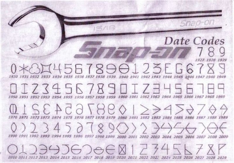

  16. ~ Snap-On did not stamp Date Codes on Military Tools : youngfred
