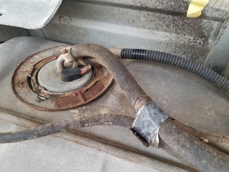

... As I worked the new fuel tank into position onto the straps, I noticed the LSV appeared to be sitting kinda cockeyed and not too horizontal. I remembered lifting the frame in order to install the sensa-trac's. On the way back down, the LSV musta flipped. Lifted the frame again and corrected the LSV position. ~ Should the lever be in a more horizontal position ? The Sensa-Tracs lifted the frame some ??? youngfred
... I asked him the same thing. 'That Sending Unit Guy' (He goes by), told me: "Depends on the Condition of what you send me." ~ The printed-circuit board was reusable. It just needed the wiper arm replaced. The arm was all green and corroded. He changed out the float, too. It came out to under a hundred bucks, total. youngfred
The sending unit frame cleaned up real good, even though it was coated in wet and dried-out film. Soaked and brushed on Sea Foam for about a week. Used a new Bosch Pump and sent out the float and printed board to : http://tristarrradiator.com/index.html youngfred

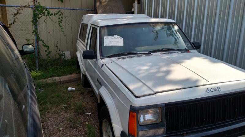

... Thanks, It's turning out to look like a hidden gem, that was waiting-on-me, under that tree for all of that time. youngfred

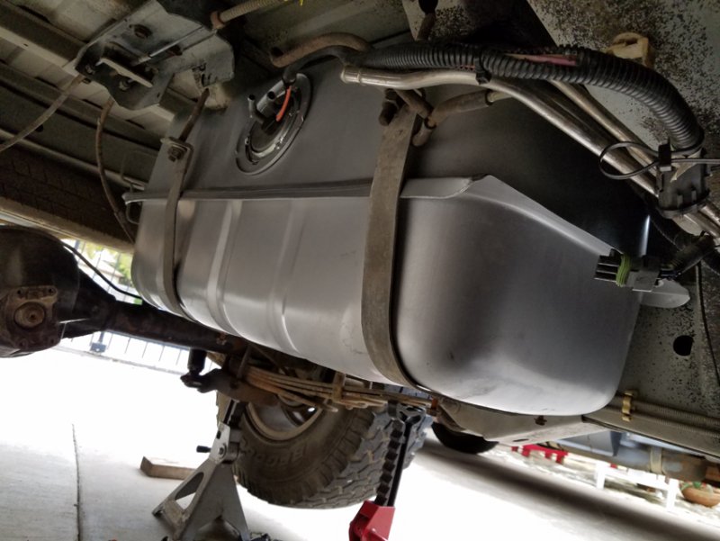

... I am glad that I did not, just-put-gas-in-it. The fuel tank had toxic things, floating about. Dark, shiny, smellly, hack-saw!!! I got rid of it and got a new one. Here it is, already in: *I'm bringing it back down, because the vacuum hoses require some - re-di-rection/attention. youngfred

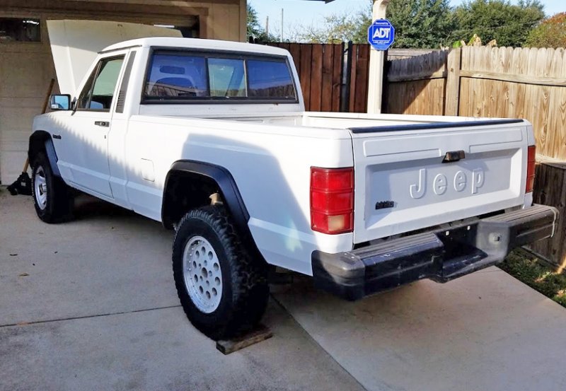

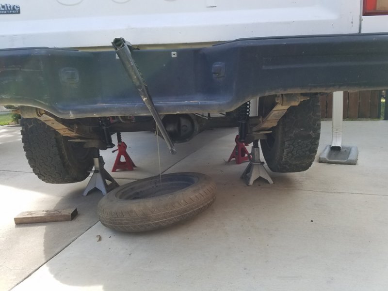

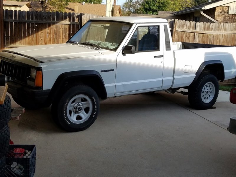

... Got the fender flares all cleaned-up and painted. I had just finished installing the transmission. The new rear shocks, just dangled until I dropped the truck then lifted from the rear bumper. Went with the Sensa-trac's with coilovers. The shocks that I removed were toast. So, I am trying to get used to the rake. Kinda extreme, for me. I will probably go with new front springs when I get up to the front. ~ The two front tires would not hold air so I put a couple of rollers. Probably haul a couple of dirt bikes at the most, so I get a chance look and help decide tires: Radial T/A - raised white letters or black All Terrain T/A - youngfred

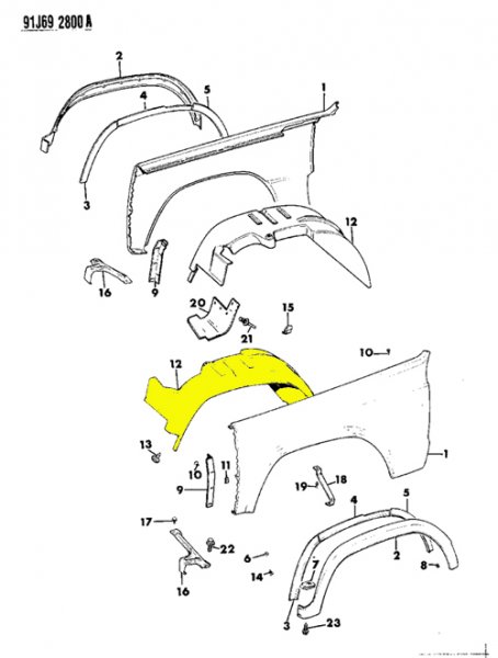

... I did not remove those because the front-flaps were still in good shape compared to the fender liner. I will be installing on the outside, front-corners where the fender flares meet the front deflector. My pop rivet gun nose pieces do not go up to that diameter. ~ As I recall, used these on the replaced front-fender liners. youngfred
... The original mounting has each stud/nut sticking out around the wheel well, with the nut and the threads exposed to the elements. Even after cleaning and wire-brushing all of the exposed threads, some of the studs still snapped. The rivet-nuts are installed with the nut/threads facing in the opposite direction and they ride inside and behind the outer lip of the - Inner Protective Panel. Now, the only thing showing around the wheel well is the head of the (new) bolt that screws into the rivet-nuts. youngfred
