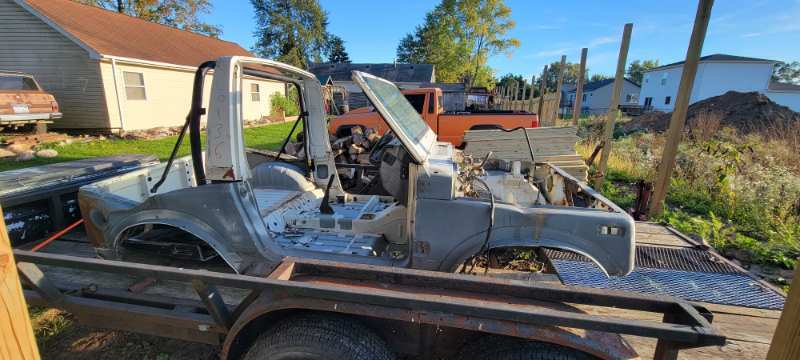

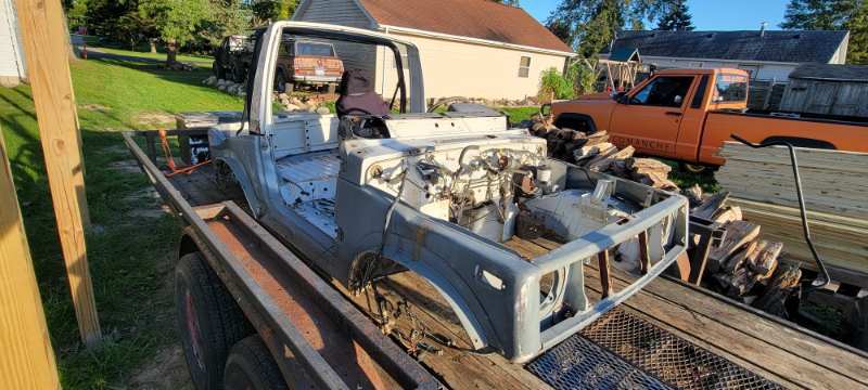

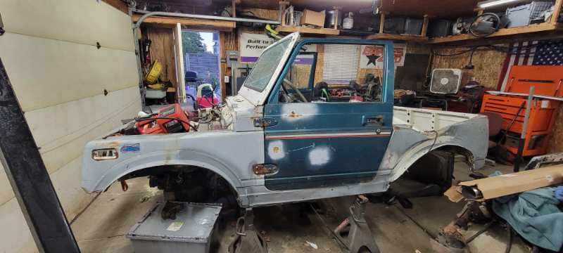

ThatJeepGuy Posted September 28 Posted September 28 Are there any Suzuki samurai folks here?? I've got a newly aquired samurai body, an extra jeep drivetrain/axles and questions...
neohic Posted September 28 Posted September 28 4 hours ago, ThatJeepGuy said: Are there any Suzuki samurai folks here?? Hell yeah! What’s the plan?
ThatJeepGuy Posted September 28 Author Posted September 28 4.0 i6 aw4 and 231j tcase. Custom frame. Potentially d30 axles front and rear for a 4 wheel steer build. Rear damage may get chopped and then convert this into a cab and bed truck build

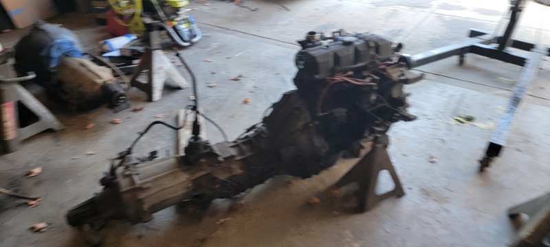

ThatJeepGuy Posted October 3 Author Posted October 3 Acquiring doors, grill and a change up in drivetrain plan today sometime

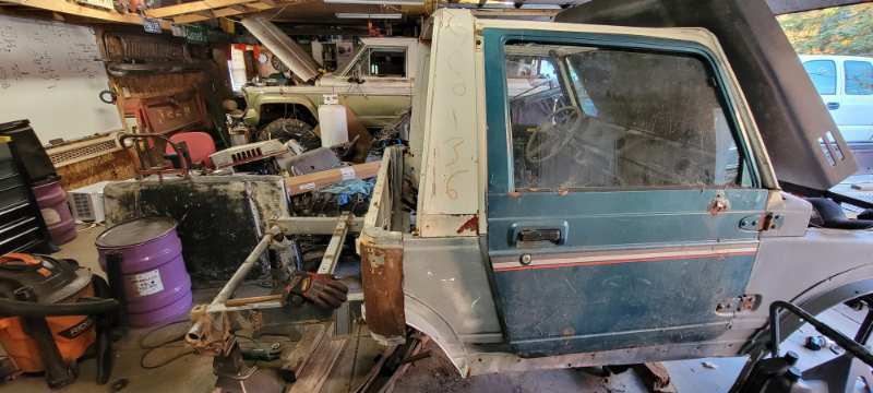

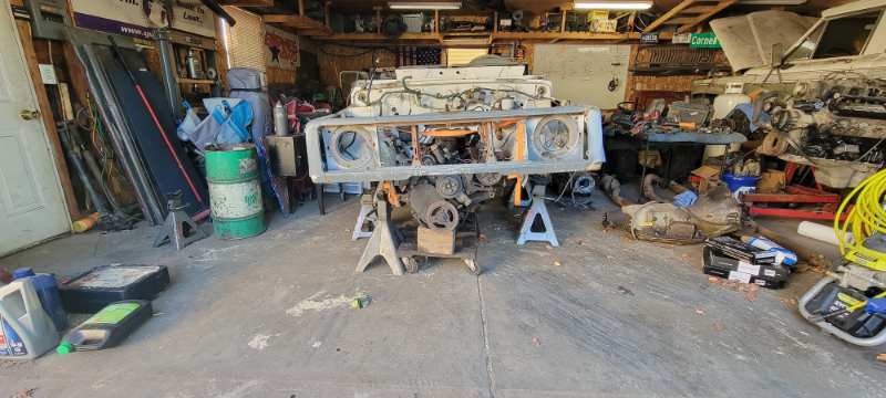

ThatJeepGuy Posted October 5 Author Posted October 5 Definitely escalating into a potential build thread... Drivetrain and doors aquired More body parts coming soon

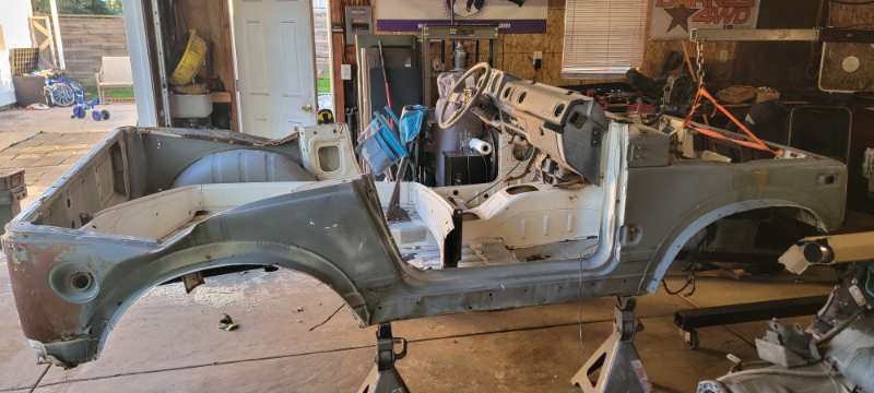

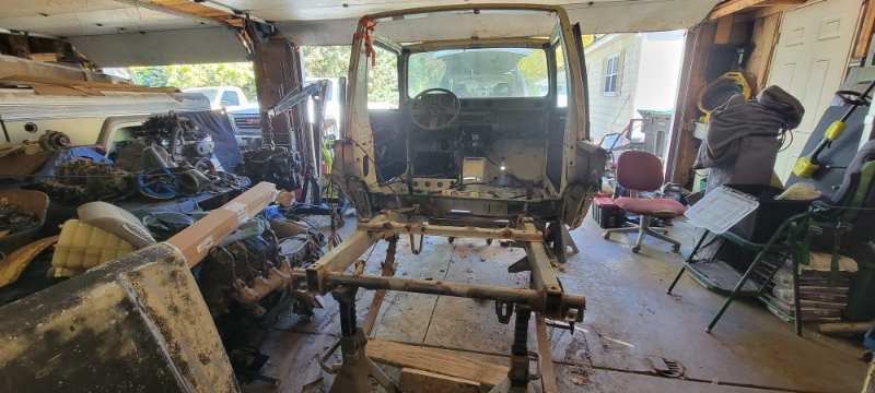

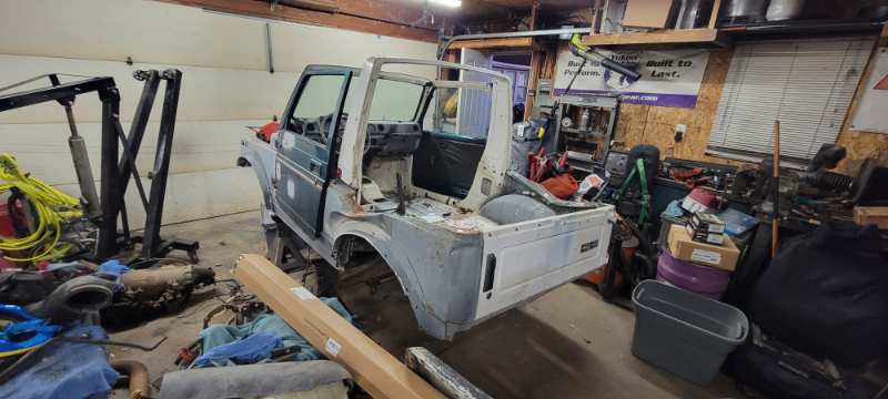

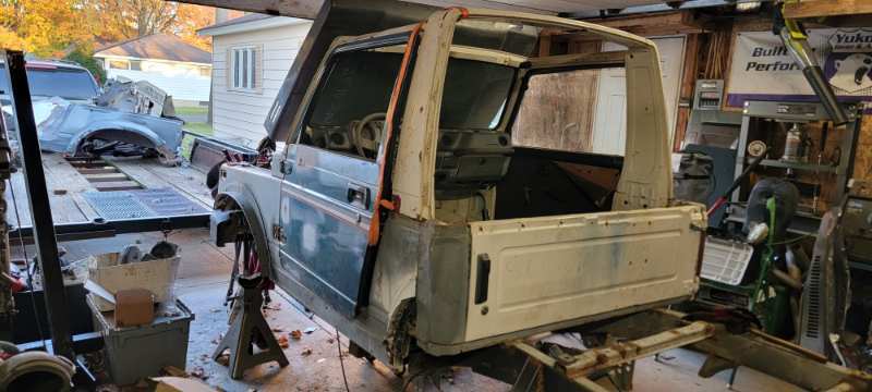

ThatJeepGuy Posted October 6 Author Posted October 6 But wait theres more! Now lets point out some body damage.. Time to commit! spent about an hour with a ratchet strap manipulating the body some to atleast get the targa aligned and bolted down - nearly there

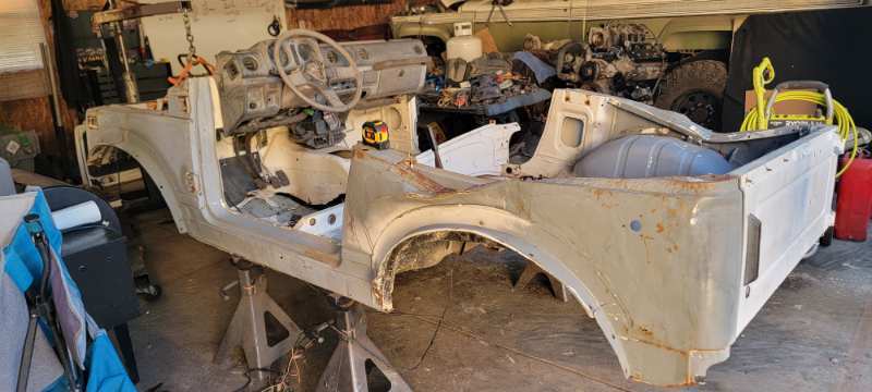

ThatJeepGuy Posted October 6 Author Posted October 6 14 hours ago, neohic said: The first cut is the hardest! Was not hard at all on this one, even did it in my "nice clothes" at the end of the night after putting kiddos to bed. Wife gave me a look while I was looking at it in the garage putting some stuff away. "what ya thinking?" Me? - firing up the plasma cutter and ditching this rear section... "soo what are you waiting for?" Yea i suppose it won't take long soo why not. My next trick will be figuring out how to un-frowny face the body to get the door strikers to actually line up with the door latches...

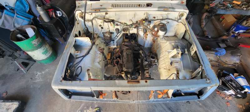

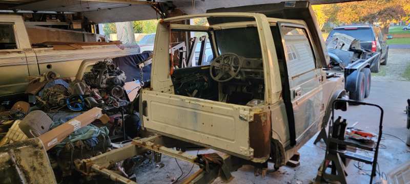

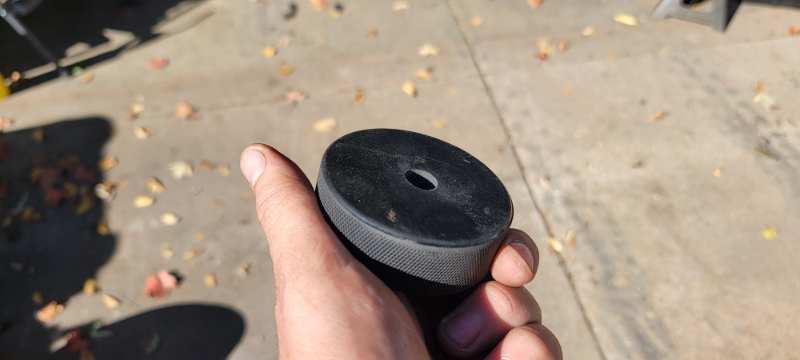

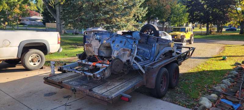

ThatJeepGuy Posted October 19 Author Posted October 19 Samurai parts pile... A member on another forum local to me shared a pile of samurai leftovers... The main grab here was a frame, doors, hood and windshield frame. Only amazons finest hockey pucks gets used for body mounts in this driveway. My current task is utilizing the frame with the body bolted down to get the body back into square for the doors and top to fit right. I'll also use this time with the frame attached to start aligning and welding in the rear of this to make it a cab.

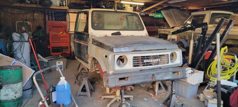

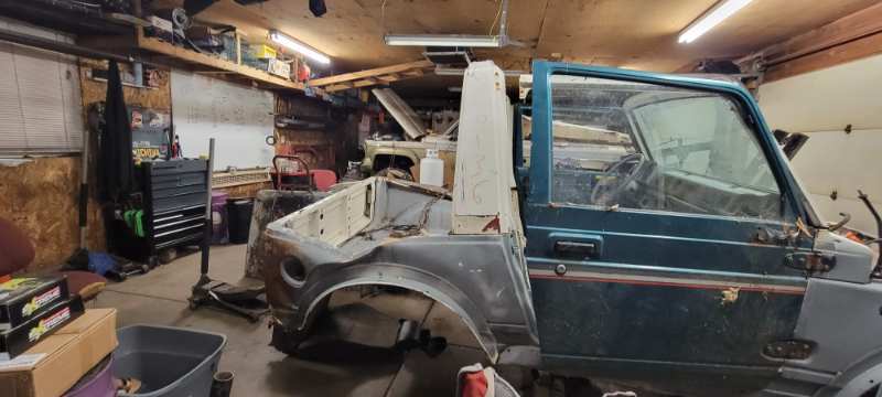

ThatJeepGuy Posted October 26 Author Posted October 26 Just a little progress over the weekend. Doors arent latching just yet but i did tickle the body some more for a closer visual tease of the back of cab setup.

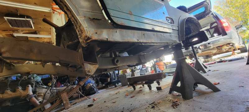

ThatJeepGuy Posted November 7 Author Posted November 7 Progress! Addressed the caved rocker panel Just as i had thought - the B pillar and door alignment were easily corrected after fixing the caved section. Door latches were sticky but got them freed up enough to open and close the doors and with those doors finally latched closed - i got started with mating the tail section of samurai body to the main portion to begin the truck cab part of this project. No close ups of my $hitty welds as this samurai metal is thinner than the XJ/MJ work I'm used to. Plan is to seam the sections together (best i can) then rear qtr armor the outsides to aid tieing the sections together and for the esthetics More to come!

ThatJeepGuy Posted November 15 Author Posted November 15 Decisions were made... Body progress is slow but things are progressing. Ive decided on utilizing the axles I'm swapping out from my jk (d30,d44) for this build. They are without issues and Free! This sets up easily for the next decision, it would simplify things if I just default to a factory frame vs building one from scratch. I'm adamant - not using this samurai frame! Soo why not just get ahold of a jk frame, utilizse all the stock suspension parts and just get creative with body and drivetrain mounting? For a mere $400 it was a done deal! More to come on this, my garage is a disaster atm

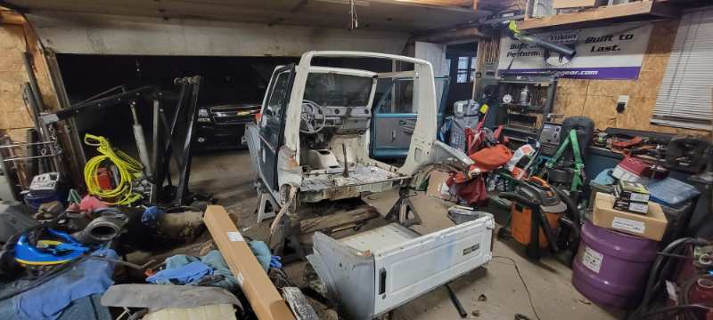

ThatJeepGuy Posted November 23 Author Posted November 23 Sketchy things went down... But with time and patience a samurai truck cab made its way onto the jk frame this weekend! Pleased with the overall placement soo far. One of my bigger concerns was the space behind the cab looking too big - but after this loose placement I think the proportions of bed/cab it going to look appealing. Had to remove the factory front body post from the samurai soo far. Plan to remove a few of the factory jk frame accesories as we move along.
