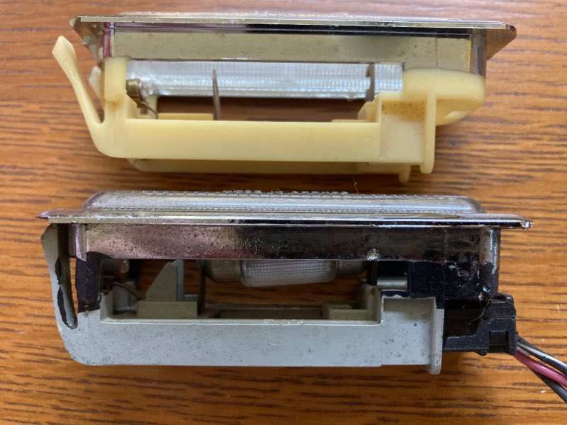

Antwon Posted 14 hours ago Posted 14 hours ago Can someone tell me why my interior lights aren’t working, the headlights and taillights and radio lights work as well of the parking brake light I know you are supposed to turn the light knob but that isn’t working
Pete M Posted 10 hours ago Posted 10 hours ago the lights themselves should rotate up and down, with one of those 3 positions being "on".
AnotherOldJeepGuy Posted 7 hours ago Posted 7 hours ago There are actual bulbs in the fixture, perhaps they have burnt out?
Torq_Shep Posted 3 hours ago Posted 3 hours ago Be aware, the factory housing are insanely fragile. Only try and take the lens off if you are checking the bulbs, do not try to pry out the whole assembly or it will break.
jodawill Posted 1 hour ago Posted 1 hour ago I've had great success repairing the clips with Gorilla Glue. I found three of the four tabs inside the pillars when I pulled the carpet. If you want to replace them, I can sell you the ones I bought and didn't use. They require you to cut the trim just a bit, which I have no interest in doing if I don't have to.
