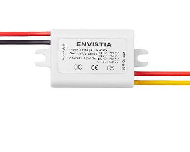

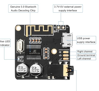

MagicJames Posted September 23, 2025 Author Share Posted September 23, 2025 @87MJTIMIf you want the easy way you can by a bluetooth cassette , Something like what I linked. however if you don't care about playing cassette you could remove the deck from inside the radio and you would technically have plenty of room to put a bluetooth audio reciver board in there. Youd need to extra room fro the step down converter to 5V. Youd run the 12V off the back fo the radio into the converted then into the chip.e You would also have the option of running an AUX out of the cassette lid. Link to comment Share on other sites More sharing options...
ghetdjc320 Posted September 23, 2025 Share Posted September 23, 2025 I sent my Rx171 to @Minuit Back a few years ago for this very purpose. Unfortunately, my radio or Bluetooth adapter haven’t been returned, but the results were promising. I sourced a really nice Bluetooth 5.0 module that intercepted the FM radio side. Essentially the Bluetooth itself had the aux input that we tied the fm radio to. The output went to the radio’s preamp. This eliminated the radio bleed through issue that the aux input introduced. The Bluetooth was the priority signal. The Bluetooth module itself could also be programmed to adjust a wide variety of parameters. Really cool stuff, but I guess we’ll never know if it works Link to comment Share on other sites More sharing options...

ghetdjc320 Posted September 24, 2025 Share Posted September 24, 2025 I’ll see if I can find the Bluetooth module that I picked up. Jeremy had it patched in and working. The issue we had is the output of the Bluetooth is a bit too hot for the jeep radio preamp board. I’m sure some added resistance to lower down the output voltage of the module or perhaps the input voltage from the fm receiver would take care of that. It’s the ideal scenario though once thats been taken care of. As for the radio project, well, it’s coming up on 3 years. Hoping some day to finish this up Edit: found it https://www.tinyosshop.com/index.php?route=product/product&product_id=1114 Link to comment Share on other sites More sharing options...
