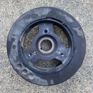

89 MJ Posted May 9, 2025 Share Posted May 9, 2025 If the rubber in the balancer is cracked, it needs replacing. Link to comment Share on other sites More sharing options...

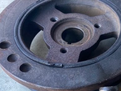

eaglescout526 Posted May 9, 2025 Share Posted May 9, 2025 Link to comment Share on other sites More sharing options...

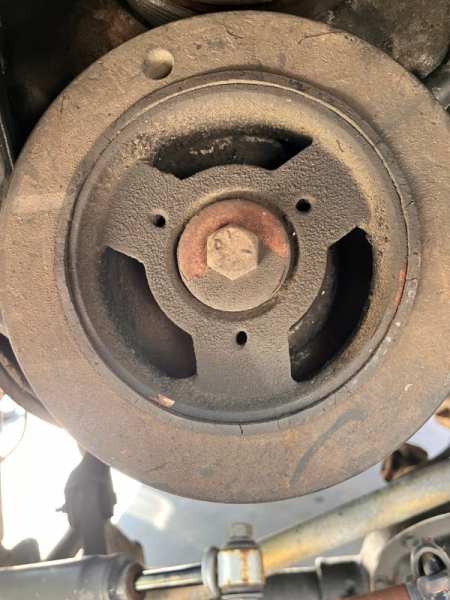

JIMMYRIG Posted May 9, 2025 Author Share Posted May 9, 2025 56 minutes ago, 89 MJ said: If the rubber in the balancer is cracked, it needs replacing. Link to comment Share on other sites More sharing options...
89 MJ Posted May 9, 2025 Share Posted May 9, 2025 Yup, that needs replacing because of the cracks. Link to comment Share on other sites More sharing options...
JIMMYRIG Posted May 9, 2025 Author Share Posted May 9, 2025 26 minutes ago, 89 MJ said: Yup, that needs replacing because of the cracks. Ok, just confused why it didn’t throw the old belt off Link to comment Share on other sites More sharing options...
fiatslug87 Posted May 9, 2025 Share Posted May 9, 2025 Two of mine were in much worse shape and never had an issue with the belts. Link to comment Share on other sites More sharing options...
89 MJ Posted May 10, 2025 Share Posted May 10, 2025 I’m not saying for sure that is the issue, but it could’ve slipped and might be at least partially responsible. Link to comment Share on other sites More sharing options...

75sv1 Posted May 15, 2025 Share Posted May 15, 2025 Its just not the cracks on the Harmonic balancer. Yours looks like the elastomer has cheeked out. So, it has lost its bond. Replace it ASAP. It can damage the main bearings. Direct experience on my part. A harmonic balancer is about $50-$60. Mine caused squealing of the belt. Link to comment Share on other sites More sharing options...
