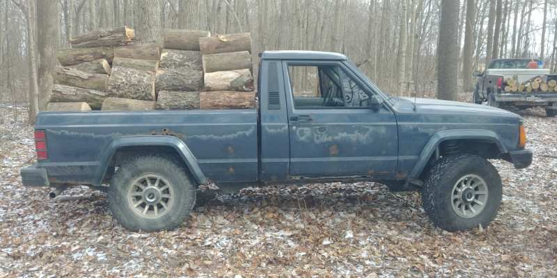

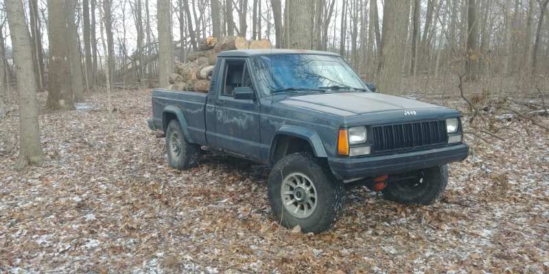

87MJTIM Posted April 17, 2025 Share Posted April 17, 2025 2 hours ago, watchamakalit said: The gs571 was never meant to be a factory replacement spring I don't believe. They probably don't flex well off road but they do really shine when loaded. WOW! I remember with my original springs loaded with half that amount of wood looking like an L.A. lowrider. I have the first batch of GS with the military wrap. I have not tested the load capacity that much since installing them. Link to comment Share on other sites More sharing options...
