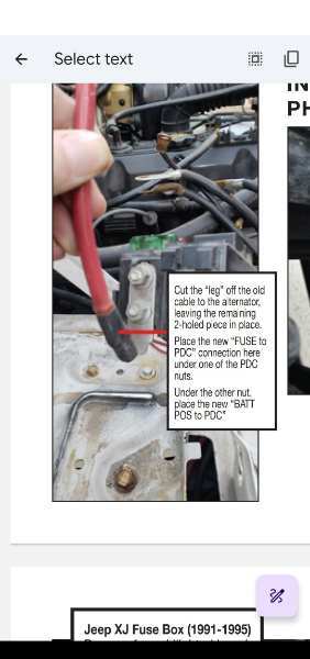

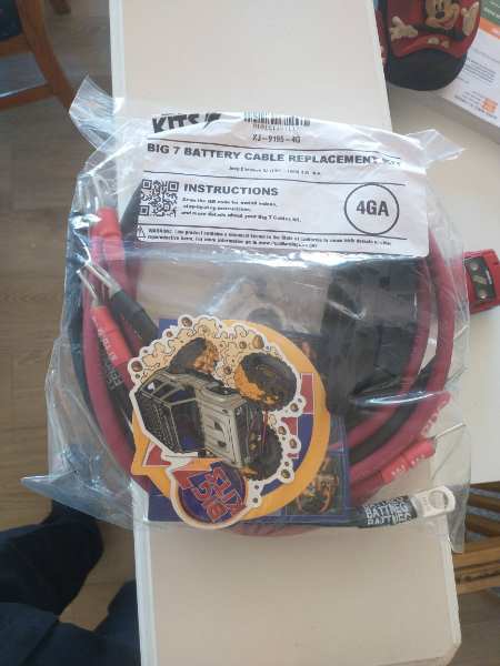

Limeyjeeper Posted October 14, 2024 Share Posted October 14, 2024 This is what you need Link to comment Share on other sites More sharing options...
Whitaker717 Posted October 14, 2024 Author Share Posted October 14, 2024 2 hours ago, Limeyjeeper said: This is what you need Thank you. I will get it ordered. Link to comment Share on other sites More sharing options...

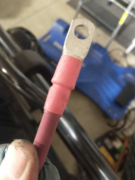

75sv1 Posted October 14, 2024 Share Posted October 14, 2024 That is including a MEGA or Maxi fuse. That would replace the fuse link, the green wire to the alternator. I have made about 3-4 sets for my own use. I use one of the cheap Chinese hydraulic crimpers. It works OK for me. I use other types of ends. Link to comment Share on other sites More sharing options...
75sv1 Posted October 14, 2024 Share Posted October 14, 2024 NAPA carries Grote wiring supplies. I try and use the fine wire cables. They bend better. Also, some say since they have more surface area, they can carry a higher load. Also, marine or tinned wiring is an upgrade. Link to comment Share on other sites More sharing options...
Spinnakerblue89 Posted October 14, 2024 Share Posted October 14, 2024 I have to say Jeepcables for me was a superior product over the ones I got from Ksuspension. Not because they were better cables, for all I know they're too similar to really tell the difference apart. But because the labeling and instructions are better with Jeepcables. That said, I would still do business with both no problem. Link to comment Share on other sites More sharing options...
