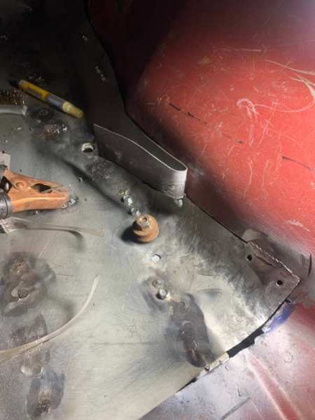

Salvagedcircuit Posted September 4, 2024 Share Posted September 4, 2024 38 minutes ago, MariaManche said: Thanks for the advice! I cleaned up the stud with a wire brush on a die grinder and sprayed a liberal amount of Kroil on the top and bottom side. I’ll see if she breaks tomorrow after work. If you removed all the spot welds in the top uniframe support, you can always try using a large prybar and prying a bit between the top uniframe support and the floor. It seems that stud is not welded to the uniframe. It looks like something is pressed on over the stud into the uniframe support. Mine looked like a pile of rust, and I could not tell. I tried to remove my stud from the cab and it just snapped clean off. It may be easier to remove the stud from the bottom side, but be careful of your brake and fuel lines. If you plan to reuse them, it's not good idea to heat up brake lines. The fluid does not like extreme temperatures and I'm sure the old lines are not up for it either. There's a few of those plastic fuel / brake line clips around that location. Un-clip them all and try to push the lines out of the way. That should give you more room to work. Obviously moving the fuel lines as far away from the torch as possible is also good piece of mind Link to comment Share on other sites More sharing options...
The86manche Posted September 4, 2024 Share Posted September 4, 2024 15 hours ago, MariaManche said: Thanks for the advice! I cleaned up the stud with a wire brush on a die grinder and sprayed a liberal amount of Kroil on the top and bottom side. I’ll see if she breaks tomorrow after work. When I removed mine I did almost exactly what you did but I also applied a little heat on the top side. I used two nuts and was able to remove all of mine Link to comment Share on other sites More sharing options...

MariaManche Posted April 24, 2025 Author Share Posted April 24, 2025 New Starter is in, and Driver side floorboard is done. My advice for someone thinking about doing their floor pans is; Make sure your floor is actually in need of a full replacement. If not, just cut out the bad areas and replace with new. Buy a quality floor pan. Self-taping screws are a huge help to get everything snug. On the passenger side, I will just be cutting out the rusted-out portion and replacing. For now, I am going to get the truck back together, take it to a local jeep show (Shared in Southeast adventure planning), and put some miles on it. This method of matching the transmission tunnel shape worked great. Fasten the new pan to the tunnel with sheet metal screws, cut the pan to desired shape with cut off wheel, and then use a small reciprocating saw (with the new pan being the guide) to cut the tunnel to the exact fitment of the pan. Link to comment Share on other sites More sharing options...
