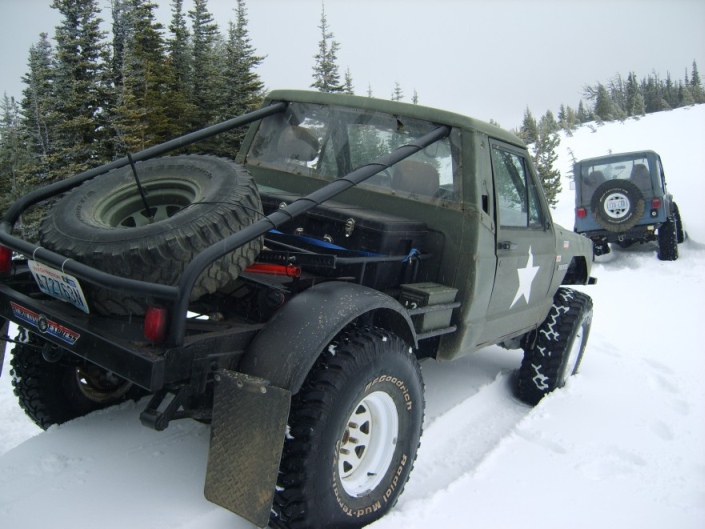

commando14 Posted April 4, 2006 Posted April 4, 2006 Glad to see so many Comanche fans out there, this is a great site. I had to share mine so here she is. The truck was bone stock and rolled when I bought it for $400 several years ago. I wish I had some before pics, but the first pic here is the earliest one I have. The top was crushed in, luckily the local junk yard had a Comanche at the time so I got the top of the cab for $75. I have a nice '69 Jeepster, but I hate taking it on the trails because I don't want to scratch my nice paint job! My goal for the Comanche was to build a trail rig. Something that I didn't have to worry about scratching or denting. That's what I built it for and it works great. I have about $3k in the entire Jeep (minus the tires), and it will outwheel rigs that cost thousands more. Everyone makes fun of the D35, but it hasn't broke yet after 6 years of hard wheeling. Details: '86 MJ, longbed Shortened wheelbase 1 foot by moving the rear leafs forward (so it's about the same as a shortbed now) Spring over in rear with some home fabbed buggy springs Full cage, plan to make top removal 4.88's, D30 front with ARB locker, D35 non-clip rear with Detroit locker 35" tires Ditched the bench seat and put in some buckets out of a Ford Probe. 4.0L/Auto swap It did have a 2.5L with AX5, NP 207 that I ran for about 3 years, but I recently completed a 4.0L swap with AW4 and NP242. At the same time I swapped the tan colored dash with a newer gray dash and instrument cluster. The firewall needs a little adjustment for rear of the 4.0L valve cover to clear, just a few hits with a hammer took care of that. Motor mounts are different, but bolt right in. The trans crossmember mounts in further back with the 4.0/auto. So you can either re-fab the cross member mounts on the frame, or I chose to re-fab the cross member to fit. The front core support is way different, had to cut away lots of metal on the front to get the radiator and air box to fit. The hood and hood latches are different, I opted to keep my hood and forget about the latches and went with some hood pins. Fuel pump is bigger than the 2.5L's fuel pump, so I replaced that. The engine, trans, and transfercase were from a '89 Cherokee. I used a complete 4.0L/auto wiring harness, dash, and ECU/TCU from a '90 Cherokee.

commando14 Posted April 7, 2006 Author Posted April 7, 2006 Thanks, here's some pics of the rear spring setup. Basically I took the stock mounting plate and flipped it upside down on top of the springs and fabbed up some new spring perches on the axle housings. The shocks sit at about a 45 degree angle, and I used the stock shocks to run up and mount to the frame, these are to reduce axle wrap and axle hop. I'm not sure if they really help anything, but the setup works pretty well (and looks cool too!)

pingpong Posted April 11, 2006 Posted April 11, 2006 I waqs talking about the way you have the top rear spring eye mounted. It looks like you kinda did an elliptical setup, but not sure. When we set my rear shocks up, we decided since most of the wheeling I do is off camber, that mounting the shocks straight up and down was best. Axle wrap isn't that big of an issue with my rig as the alcans come with an anti wrap leaf. Even still I need to build man antiwrap bar eventually. I think we will do that when we swap the D60's under my rig :twisted: Love the paint job. I think you would have been happier swapping in a built 4.3 or 350. its just about the same amount of work. I am on the prowl for an mid 90's 4wd balzer or s-10, that has been wrecked. hat way I can get it cheap, and get everything to do the swap.

DirtyComanche Posted April 18, 2006 Posted April 18, 2006 I waqs talking about the way you have the top rear spring eye mounted. It looks like you kinda did an elliptical setup, but not sure. I won't speak for him; but it looks like a 3/4 eliptical setup. I contemplaited one. Then got lazy.
