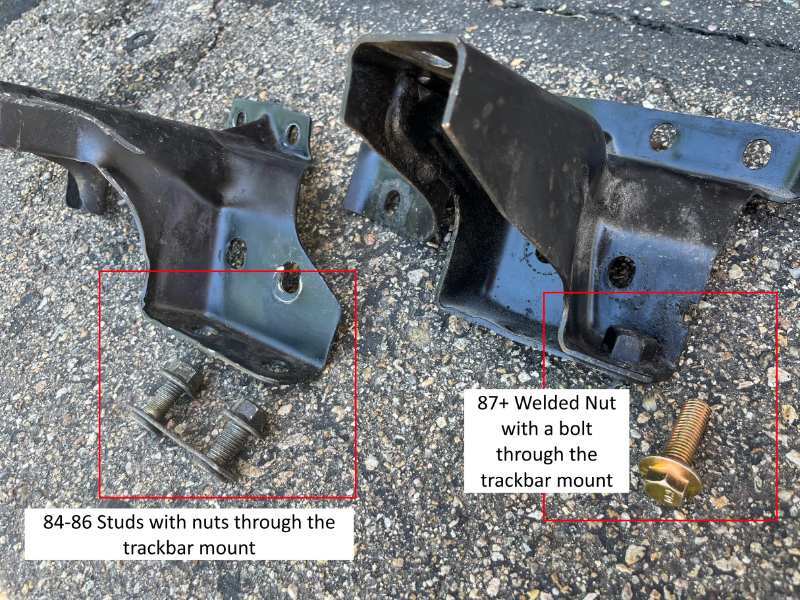

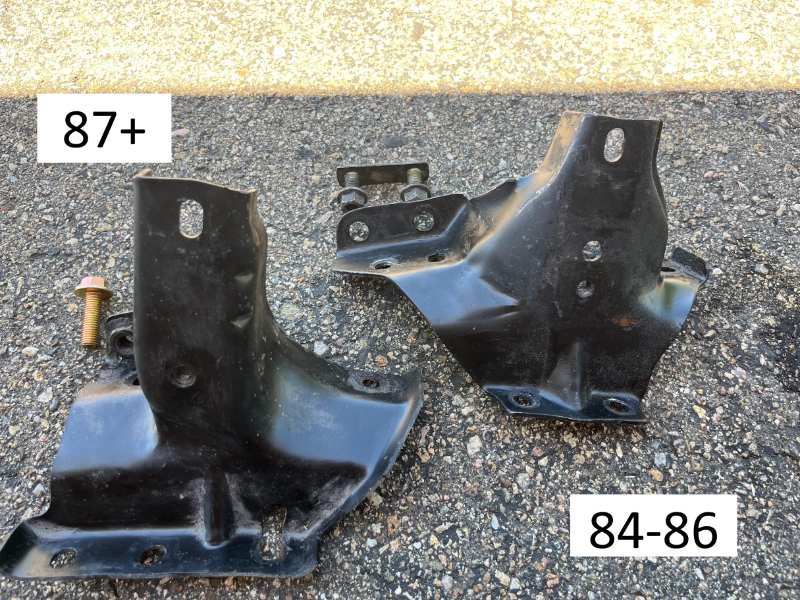

aris_garage_builds Posted Tuesday at 10:46 PM Posted Tuesday at 10:46 PM Wanted to add that the Driver's Side Engine Frame Bracket is unique to 84-86. (It appears the passenger side is the same? Although I'll be able to confirm shortly lol). The 87+ frame bracket moved forward a few inches on the unibody to make room for the 4.0l. Here's a photo showing the difference - you can see that the 4.0l block doesn't line up with the 86 frame bracket.
eaglescout526 Posted Tuesday at 10:48 PM Author Posted Tuesday at 10:48 PM 1 minute ago, aris_garage_builds said: Wanted to add that the Driver's Side Engine Frame Bracket is unique to 84-86. (It appears the passenger side is the same? Although I'll be able to confirm shortly lol). The 87+ frame bracket moved forward a few inches on the unibody to make room for the 4.0l. Here's a photo showing the difference - you can see that the 4.0l block doesn't line up with the 86 frame bracket. Huh. How neat. Will you be able to move the mount forward?
aris_garage_builds Posted Tuesday at 10:50 PM Posted Tuesday at 10:50 PM Just now, eaglescout526 said: Huh. How neat. Will you be able to move the mount forward? Sadly no, the unibody in that section is curved so each frame mount is shaped slightly different. I had to pull one off of a 87+ for my 4.0l swap. I'll try to get a picture of each one side by side - very subtle difference, but not interchangeable.
eaglescout526 Posted yesterday at 12:08 AM Author Posted yesterday at 12:08 AM 1 hour ago, aris_garage_builds said: Sadly no, the unibody in that section is curved so each frame mount is shaped slightly different. I had to pull one off of a 87+ for my 4.0l swap. I'll try to get a picture of each one side by side - very subtle difference, but not interchangeable. Yeah please keep us informed. This is good info right here that I don’t think many people talk about when doing the swap.
