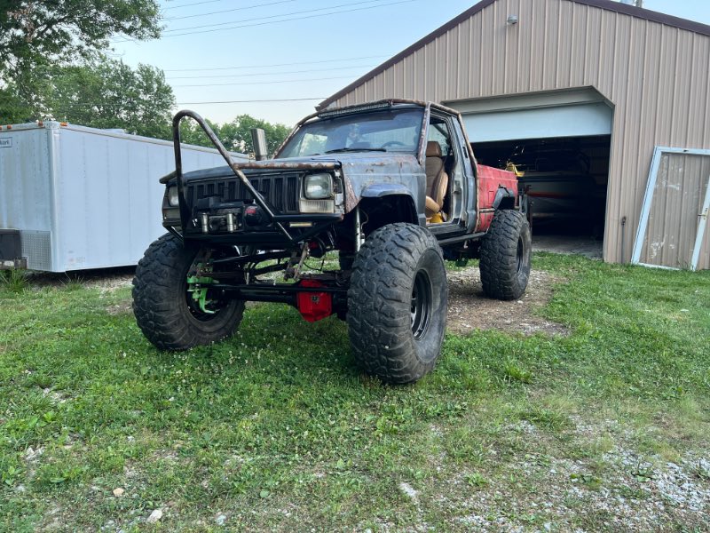

iimafa Posted November 29, 2023 Author Share Posted November 29, 2023 I welded the front diff over the weekend and took it out for the first time to haspin acres, And oh lord was it impossible to steer (as expected) when it was locked in, so I kept jumping in and out locking and unlocking one of the hubs. all went well on the shake down run. Heard a noise a few hours in so I jumped under it and found the rear drive shaft bolts were loose so tightened them up. Later on I pressed the start button and she went completely dead and found I blew one of the main 150 amp fuses, no biggie, I swapped it out and no other issues. the next step is hydro assist, looking at the 1.75”x8” PSC ram, hopefully I’ll be ordering it in the next few weeks. There’s a few little things I need to be addressed before this build can be considered “finished” and I will attempt to address those over the next few months and those include 1. tail lights 2. front winch solenoid 3. front tube fenders 4. New batteries 5. organized tool box 6. Overhead speakers 7. Bed tool box 8. paint the boom after that, it’s 5.38s and ARBs when the funds allow…. That will be the true finish line…. Until it’s times for a drivetrain swap, thinking an OM617 with an AW4 and an atlas 4 speed… or that might just become a different build all together… Link to comment Share on other sites More sharing options...

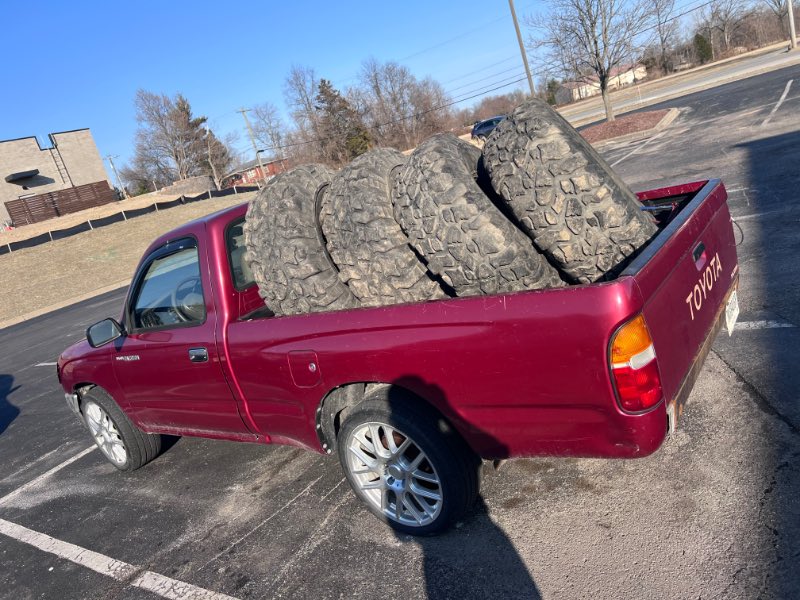

iimafa Posted February 4, 2024 Author Share Posted February 4, 2024 Had a pretty heavy snow day here in Indiana so went ahead and drove the rig to work. Cruises down the road very very nice. Before the turbo it struggled to maintain 50-60 mph on 33s, but I was rolling that with no real issue on the 41.5s!! Very impressed. I wired the wastegate shut the other day because the bolts keep backing themselves out. This caused some massive boost spikes, a few times it touched 13-15 PSI…. Which is not what I want but geez the 2.5 felt like it had some power. It very easily runs away with the AFR now so the stock injectors need to be swapped out for some larger ones. Either 4.0 injectors or mustangs, I’ll get to that soon. i also found a steering box brace for $100 on Amazon so grabbed that and went to install but found it didn’t fit at all with the 2.5 radiator. So chopped it up and made it work. Turned out pretty good though. this is how it looked out of the box chopped and welded before grinding the welds smooth after paint this shows how the radiator hangs between the frame rails. This is the main reason it doesn’t fit, the 4.0 radiator is squeezed between the core support and doesn’t come this low. this is wit it installed this shows how it fit around the pitman arm. Does a very nice job of holding the box. I went ahead and mounted another fire extinguisher on the rig. I see way too many videos of rigs burning down and don’t want that to happen to mine or any of my buddies. Very very simple mount, it uses zip ties. The idea was to have it out in the open where anyone could get it if needed. The mount will most likely break if it’s ripped off but that’s just fine. It’s a single use system anyways. this is my hornet finally making its way in the garage, honestly I think everyone needs a vehicle with a boom. This rig has helped out so many times. Link to comment Share on other sites More sharing options...

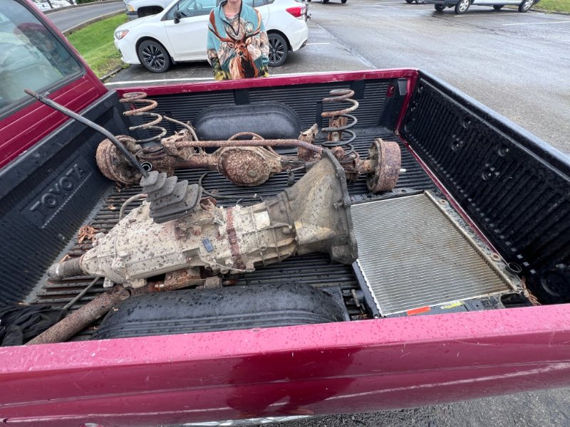

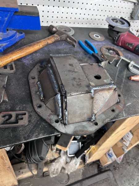

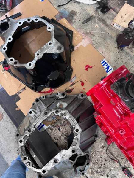

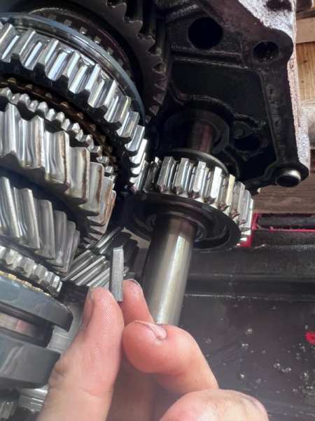

iimafa Posted May 9, 2025 Author Share Posted May 9, 2025 Few small updates with the rig,I’ve been using it around the house more than anything and took it out in the snow a few times, while out in the snow I managed to break reverse, so found a used trans from a wrangler and going to be throwing that in in the next few weeks. Also i managed to score some 5:38s for the front and started making the front diff cover, it’ll be awhile before i get them in but slowly getting the parts i need. update in the shop, I finally got a 2 post lift so it should make life a little easier I started off by swapping on some new to me 42s pittbulls on some steel wheels, they’re not nearly as cool as the methods, but it’s what I got so it’ll work fine. slow progress recently as I’ve been spending most of my time working on the barn itself, so once I get that straightened out I should have some more time to finish it up. Link to comment Share on other sites More sharing options...

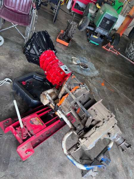

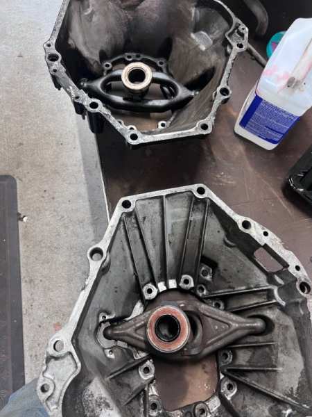

iimafa Posted June 17, 2025 Author Share Posted June 17, 2025 Had an issue that when it was in reverse it sounded like someone was hitting the transmission with a hammer, so yanked out the ax4 and tossed in a used ax5 from a wrangler in the old girl, went ahead and slapped some paint on what I could while I had it apart and doesn’t look half bad. I tossed a new throwout bearing in it while I was at it. Also I found out the 2.5 86-89 external slave bell housing is indeed different than the newer 99-2000s wrangler bell housings as seen below in the pictures. I wasn’t aware of this difference when I picked up the trans, either can work but the parts cannot be mismatched between them, the bolt pattern for engine and the trans is the same but different for the slave cylinder. Link to comment Share on other sites More sharing options...
iimafa Posted July 8, 2025 Author Share Posted July 8, 2025 Got it all back together, spent most of the time touching up some of the paint pounded out some dents, changed the oil and slapped on a diff cover I made a few years back. She’s ready for some action, just need to get a trip planned! Link to comment Share on other sites More sharing options...

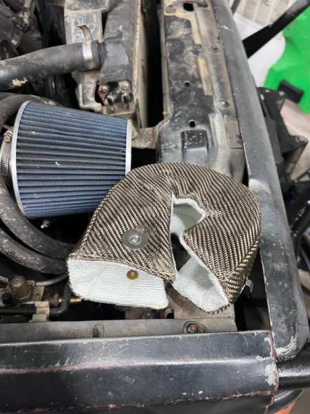

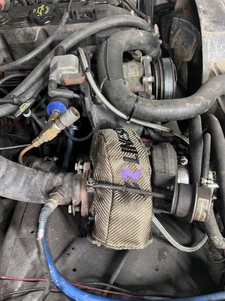

iimafa Posted October 1, 2025 Author Share Posted October 1, 2025 Not much action of the tow truck recently, I’ve been using it around the yard to move things, pulled some fence posts with it and drive it occasionally. It gets very hot under the hood and the coolant temps have been going above 210 the last few times I’ve run it hard so I may be tossing a new waterpump on it soon and flushing the cooling system. I got a turbo blanket in an attempt to keep some of the heat out of the engine bay, I haven’t run it yet but hopefully it helps some. It was a cheap one from Amazon, grabbed it fro $20 and it fit pretty good considering the strange turbo. Link to comment Share on other sites More sharing options...

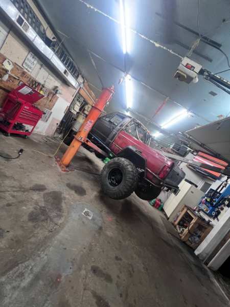

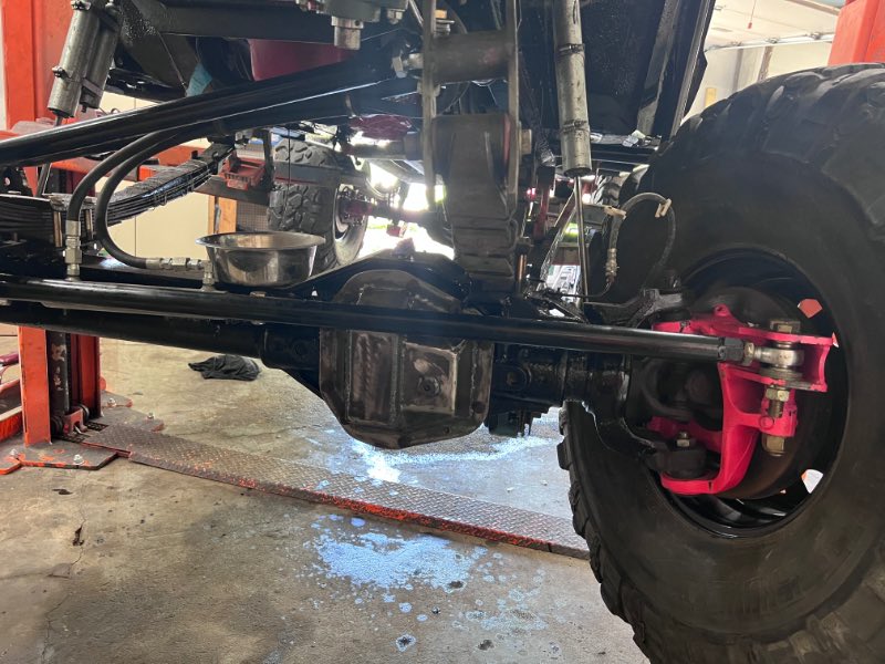

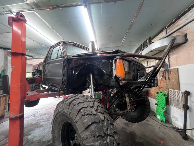

iimafa Posted February 26 Author Share Posted February 26 After adding the turbo blanket the temps under the hood have gone down a lot it seems. I’m excited to see how it feels in the summer, but it did great ripping through the snow we got the other day. I pulled it into the shop to redo the rear shocks and add some larger air bags, the air shocks from an Escalade weren’t cutting it and with enough weight the tires were forced into the wheel wells. So I started on these, should be about 2500lbs per bag at 80 psi, along with solid bumps set to keep the wheel out of the tub in the worst case. Link to comment Share on other sites More sharing options...
iimafa Posted Tuesday at 12:14 AM Author Share Posted Tuesday at 12:14 AM Got the bags setup and took it out for a weekend in Kentucky. It went great, bump stops worked how they should and the bags kept the tires off the frame. Link to comment Share on other sites More sharing options...
