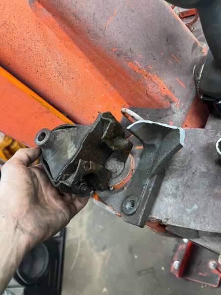

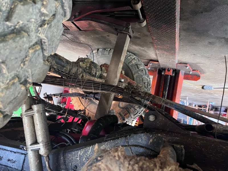

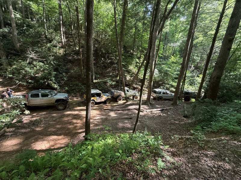

Took the rig out to hollerwood for the weekend and finally got my half doors installed. Rig did great, and we sure had a good time. On the second day I took the hood off because of an overheating issue that seems to be getting worse, with the engine exposed I noticed a lot of movement in reverse so checked it out and Found out the motor mount was pretty well destroyed. Some chicken wire held it together for the weekend and when I go home I found it was broken on both sides of the rubber mount. in the middle of the night I took the rig off of a pretty large drop and managed to catch the leaf spring. I can’t decide if I’m going to try to replace them or keep running it. Chicken wire for now.
