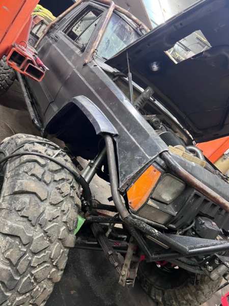

Started working on the interior after I found a NICE Cherokee in the yard so swapped the bench seat for a center console, snagged some door panels and some seats, got the exhaust done, battery’s fully mounted, And battery box done. And also scored a 2010 Ford Dana 60, Then we partied a little to hard at the shop and We got kicked so had to move this fine unit one last time!

And that brings us up to today, it’s currently in the single car garage of the house I rent, so a lot of the time has been me getting the garage set up And house together, but progress is still being made, all the wiring is done except for the rock lights, fuel line is run, just need to finish the intercooler piping, and make a fuel cell and she’ll be ready for the first start up

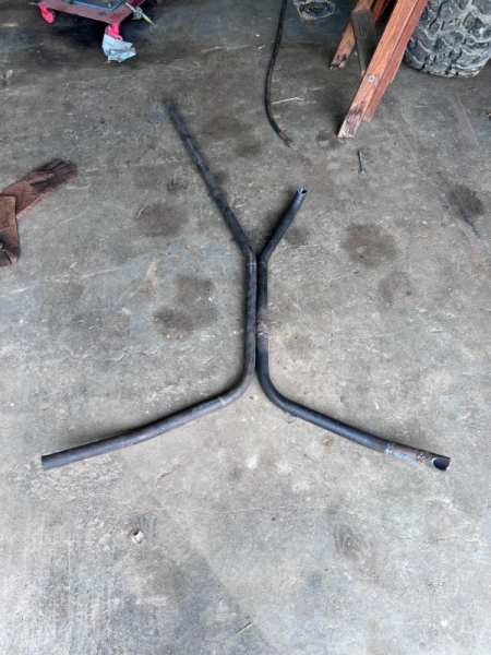

How do you plan to keep rain/mud (or anything else for that matter) out of the exhaust with it pointed straight up?
I was planning to make a flapper on top of it so it should keep most of the bad stuff out..... that’s the hope atleast...
I kinda figured that was the plan, just wanted to see if you had any other plans for it.

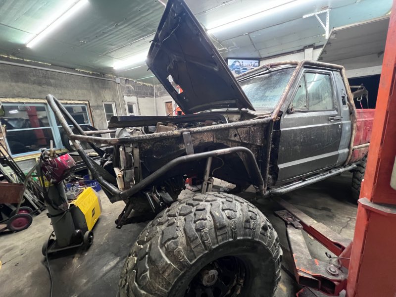

Progress On the Comanche has slowed slightly due to some of my other projects..... but a little work got done tonight! Ran alternator cables, engine ground, and got the exhaust painted. Next On the list is to run the air line and power wire from the compressor to the tank in the bed then onto the fuel cell, THEN START UP!
