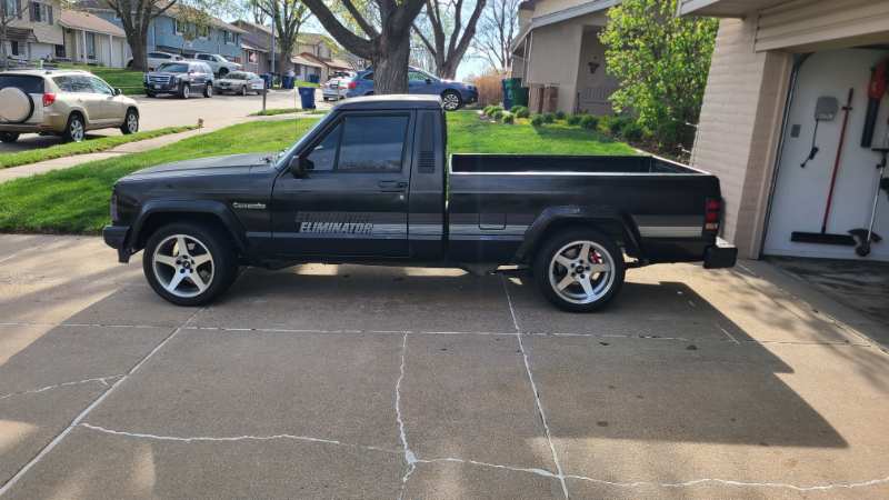

It's been a couple weeks now since I made the 1200 mile round trip journey to pick up my second Comanche pickup, and so far I couldn't be happier with the purchase.  She's had a couple small issues, but has been everything I want in a "project" vehicle.  By that I mean, mostly perfect structurally and mechanically, with a few small issues that I can fix over time while enjoying it as my daily driver.  So without further ado, some pictures from the seller before I picked her up.
1991' Comanche Eliminator
2wd - AW4 console shift
Dana 35 rear
Lowered ~3.5" using unknown springs front and 3" steel blocks rear
Aluminum Rad with Dirtbound Offroad triple fan shroud and 3x Derale 10" fans with PWM fan controller
Newer belt, idler puller, thermostat, water pump and rad hoses
Grant steering wheel
Smoked signals/tails and LED headlights
Factory 3pc glass rear window
Clean, rust free texas truck (unheard of in NE)
