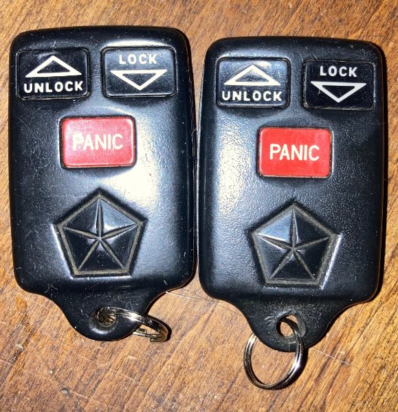

It’s a GM RF module actually. I did a Google search and found this link. I studied this link and the embedded camero forum link in his post that has the schematics for the harness for about a good week. It’s compatible with the later Chrysler era fobs.
I made a whole note pad on it in my phone and studied that too to make sure I get this right.
Ideally you want the module from a yard with the connectors. If not they’re simple female end metri pack 150 and 280 connectors.
As far as years, it’s very compatible with all of them. You really just need to know where your unlock and lock colors and you need the keyless harness from an XJ. You could free hand it but that would be a royal pain and take too much time. I simply used the keyless set up I already had and just connected into that harness.
