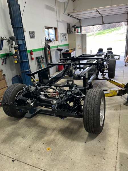

The filler neck goes into the stock 2000 tank. With the exception of the ABS being deleted, this truck will be a completely stock 2000 Silverado. All of the drivetrain is unchanged, as is the suspension.

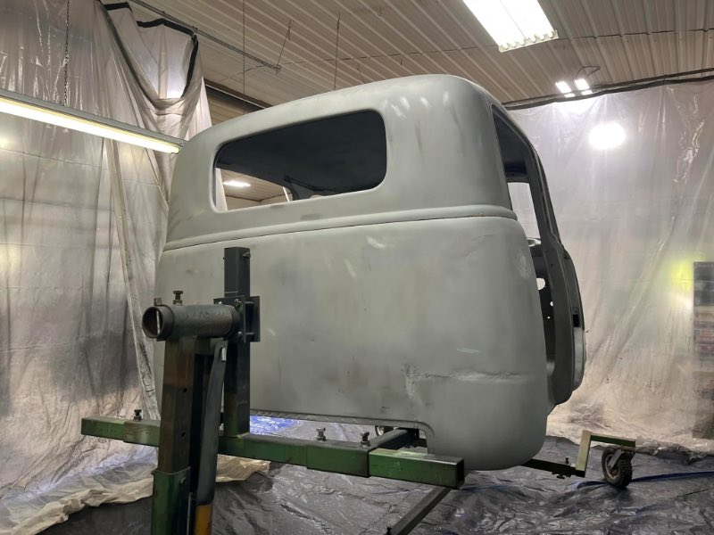

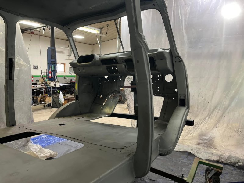

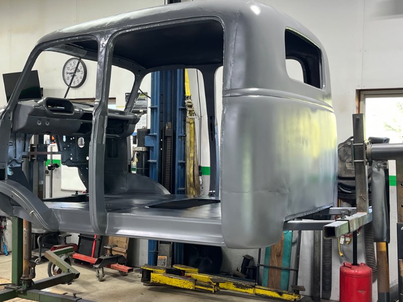

More pictures of the cab after blasting and ready for primer. The firewall did not get blasted because it is going to get smoothed.
  • 1 month later...

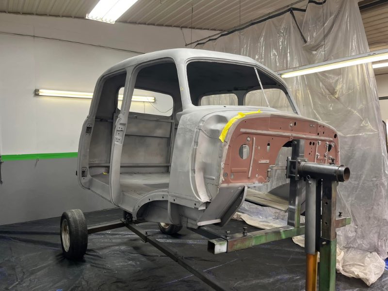

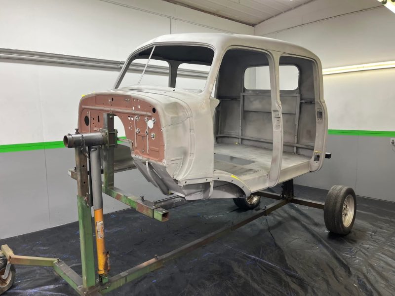

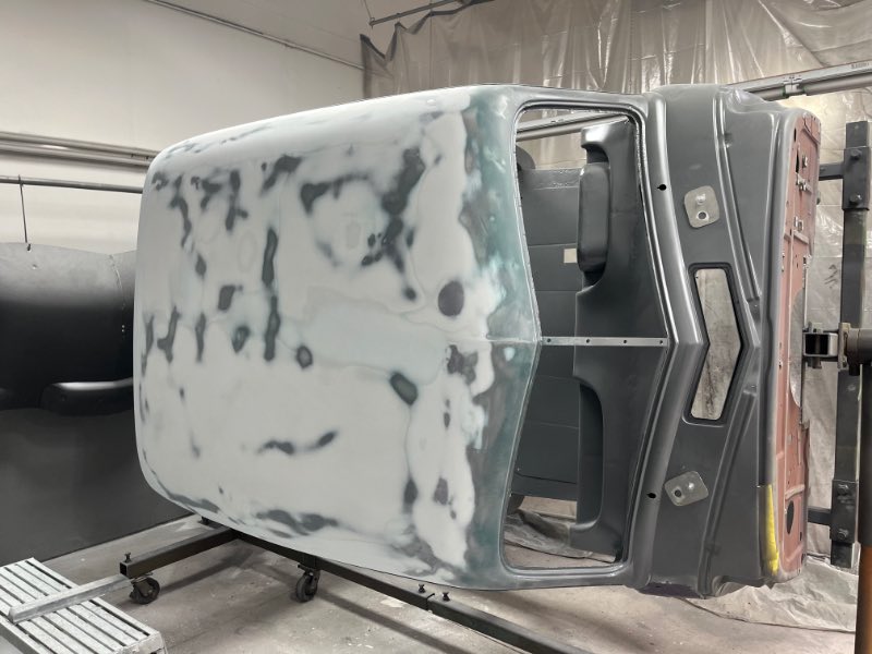

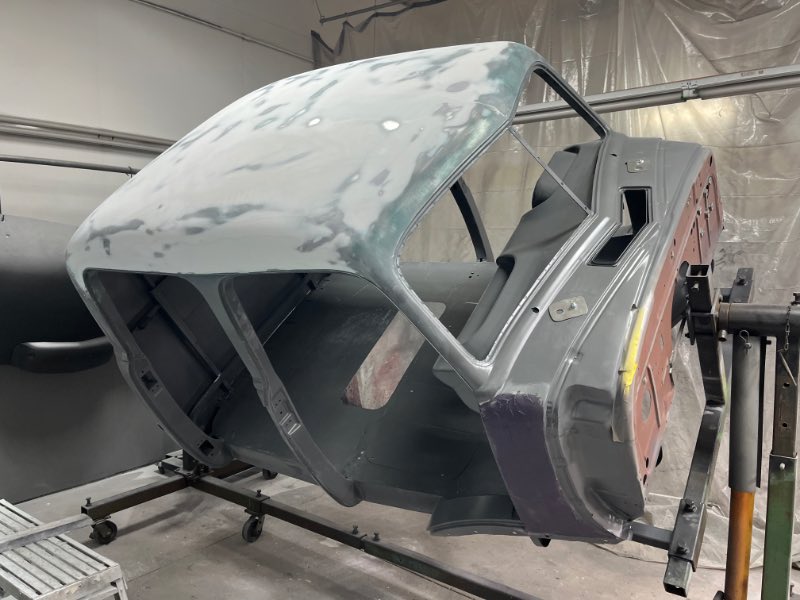

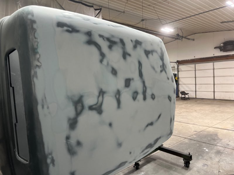

The cab got primed about a month ago. It looks wavy in the pictures, but that’s mostly because the primer was still pretty wet when the pictures were taken. It really won’t need much bodywork at all.
The doors are almost finished and ready for bodywork now too, but no pictures.

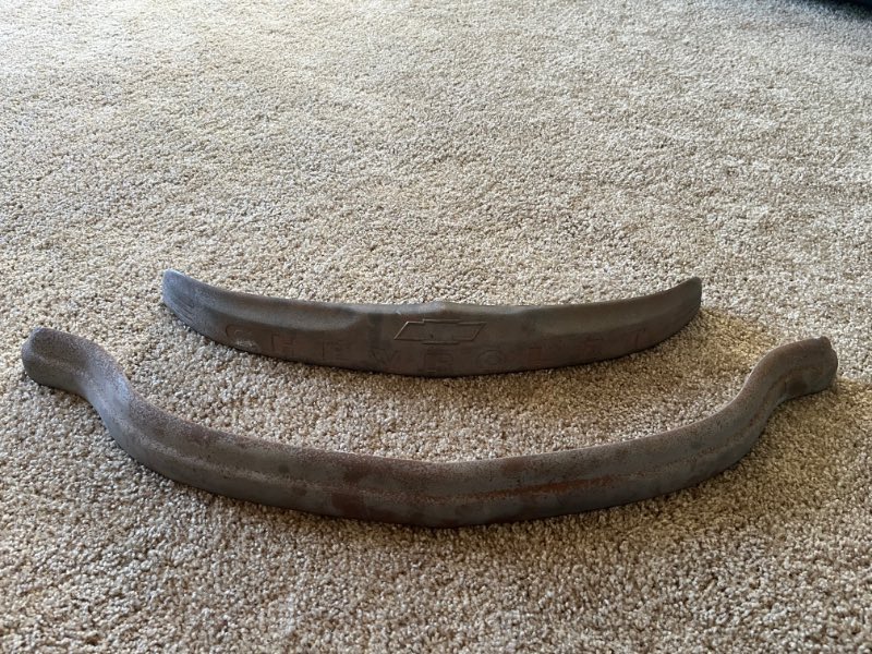

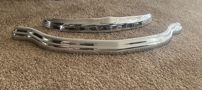

I was sent back to Tucson with some grille parts to get chromed.

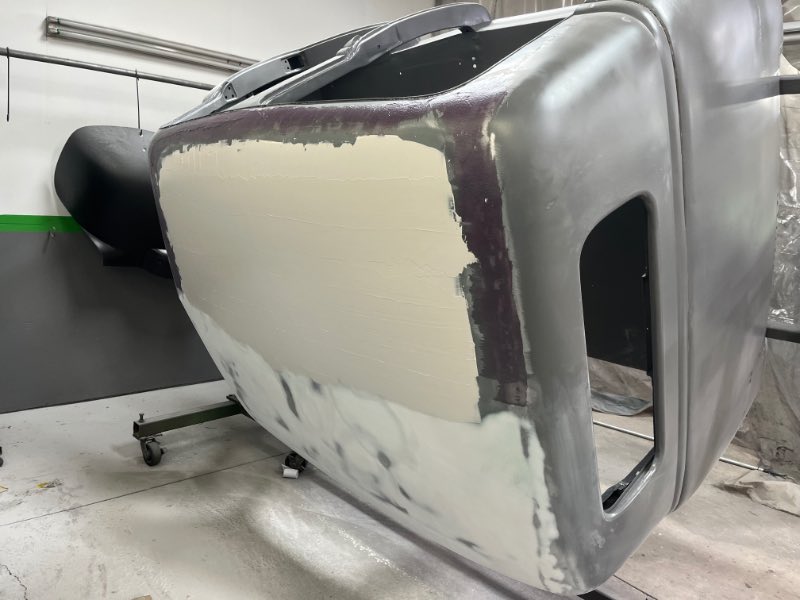

Grille parts have been dropped off at the chrome shop. The spreading of filler has begun on the cab. Fiberglass filler over anywhere that had welding done, then just a skim coat over everything else to get it perfect.
