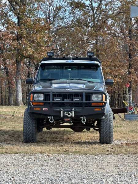

TexanEliminator Posted March 5, 2019 Author Share Posted March 5, 2019 I’ve redone the suspension on this thing 7x to finally get it perfect. Forgive me for not taking in progress pics, but we’ve all seen lift kit installs on these. I honestly can’t remember what attemp this was but it’s close to where it is now. I’ve gone from a 2.5” superlift coil spring/AAL kit, to adding a 3/4” spacer and General spring replacements with JKS shackles (still rubbed) to 3.5” RE coils (rubbed again after ARB and warn M8000 winch) to RE 4.5” coils and Rusty’s 4” springs (sagged horribly very quickly in front a started rubbing and looked like Joe Dirt’s car) to 1.75” spacer (4.5” springs had no flex left and bottomed out horribly) to RE 5.5” coils and adjustable RE lowers (rode like a Sherman tank and wheel sat too far back in wheel well) to RE adjustable uppers and RE CAD. I think I finally got it right after several hundred dollars and many long nights. Blood sweat and tears went into the suspension of this truck! As it sits now, just to recap, 5.5” RE coils, JKS track bar, adjustable RE upper and lowers, RE CAD, RE extended brake lines, Rusty’s 4” springs, JKS shackles, Fox shocks on all 4 corners. The headache rack is not on there anymore. It caused the toolbox to sit too high. Also have a scarfab receiver hitch I forgot to mention. Link to comment Share on other sites More sharing options...

TexanEliminator Posted October 7, 2024 Author Share Posted October 7, 2024 Been awhile since I’ve been on here with Facebook killing the classic forum. This old girl is still kicking with 340k on the clock! I no longer pipeline and now shes the fishing/ranch get around truck. Link to comment Share on other sites More sharing options...
Salvagedcircuit Posted October 7, 2024 Share Posted October 7, 2024 15 minutes ago, TexanEliminator said: Been awhile since I’ve been on here with Facebook killing the classic forum. This old girl is still kicking with 340k on the clock! I no longer pipeline and now shes the fishing/ranch get around truck. Nice. 340k never looked so good Link to comment Share on other sites More sharing options...
