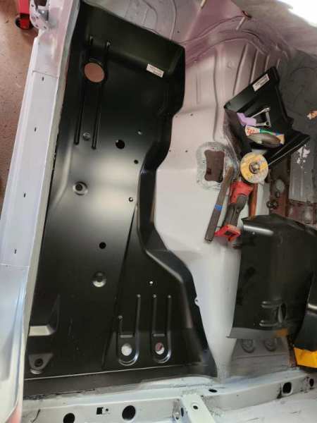

Ordered key parts inner rocker and full floor for the left side as it's all rough. And started cutting away.20250414_180008.jpg.803a49395abf096cb55d4cc5dcf932ae.jpg

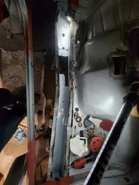

Tackled the inner rocker last night. The amount of seam Sealer you have to fight is absurd.

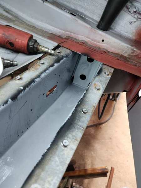

Outer rocker cap. Half the welds did not hold from the factory.
What's left of the outer rocker behind the cab corner. Will have to figure out repairing and stitching to the new rocker.

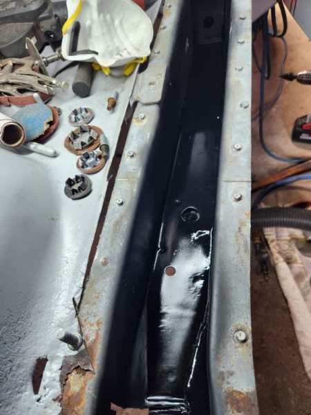

And a clean looking at the inner!
The welds that hold the inner rocker to the cab i found were.. crude. Or just not there. There were several spots that should have had spot welds and didn't.
Beads of welds in the cab holding the inner to the B pillar. One hidden behind lots of seam seaSealer.
After cutting and grinding random degrees of welds it came out.

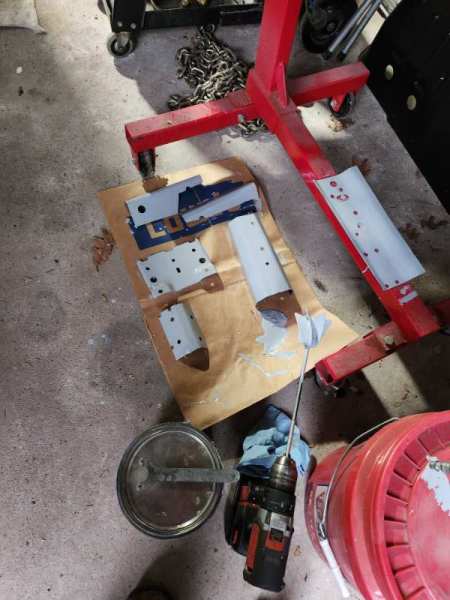

Epoxy primed at work.
20250418_093518.jpg.587bba0a80b25396287756edbb8ac578.jpg20250418_093523.jpg.d18e5740fe36fe629935846cc28d65e7.jpg
now i need to fix the kick panel extension that meets the inner rocker and it can go on!
