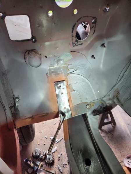

Seat belt brace!

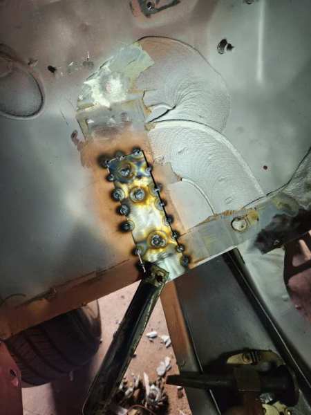

Burned in both ends. I was not impressed with amcs quality here. The brace is only welded to the floor. So I added a few tacs to the unibody for a more solid and permanent fit.

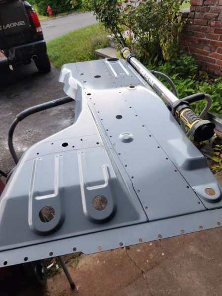

Would you just look at it!
The key parts full floor section was a pretty damn good fit. There were a few areas that needed some persuasion but we got it there.
All in all.. 10/10 would buy again. key parts floors are pretty damn good.

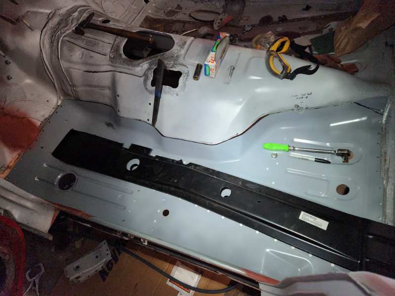

So I finished up welding the floor.

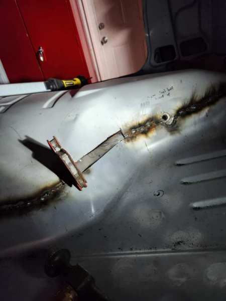

Made a small patch for the area i cut too short.
What a mess..
Addressed the burn spots on the inside of the rocker too.
I will say, that one patch was the biggest pain in my @ss..
Used metal too thin and it kept warping and blowing through and splitting.
So I ended up having to do it again. With thicker metal.
It was a struggle of chasing little pinhole. Quite frustrating. But its good. Its done. Seam sealer will finish the rest up. I cleaned up and brushed some epoxy on. I still have to clean up the underside before I can treat it.

Floor braces mocked up.
And would you look at that, it fits!
Sharpied witness lines for the brace, pulled everything back out and taped over the sharpie. Next will be scuff and some enamel before I weld the brace in
