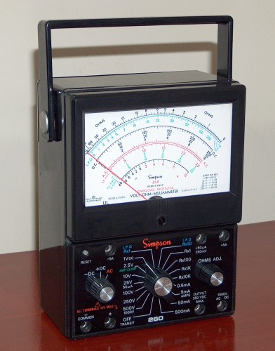

HOrnbrod Posted February 27, 2018 Share Posted February 27, 2018 I have an old Simpson 260 I've had since the mid-70's. I don't use it much except when I need to do variable output measurements. Still working on all functions like new. It looks like the below except much more beat up. Link to comment Share on other sites More sharing options...
