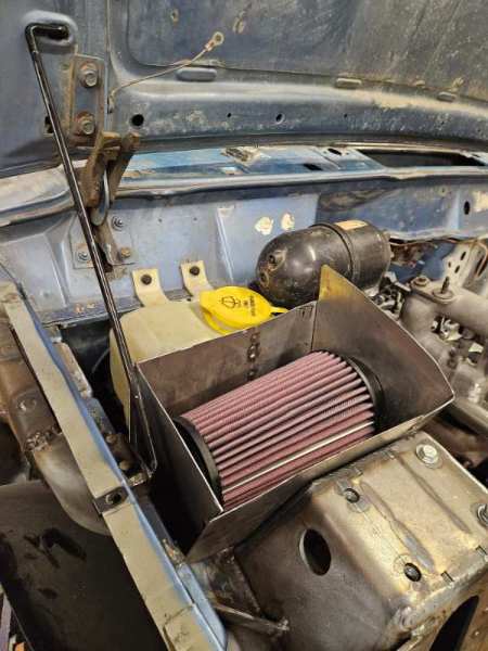

Ye olde original engine was on it's last legs so I picked up a ~50k H.O. engine from a '95 XJ.  I changed every gasket on it before swapping it.
Before:
Donor:
After!  I ended up modifying the Renix intake to work with the H.O. head and exhaust manifold.  All it took was an EGR delete plate and welded-shut tube, some minor grinding at the corners of the intake, and a trimmed gasket.

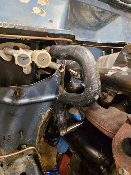

1/2 ton Chevy hoses (NAPA 38183 and 38182.)  Had to modify the bracket, and I'm not so sure they're not going to contact the wheels; we'll see.
