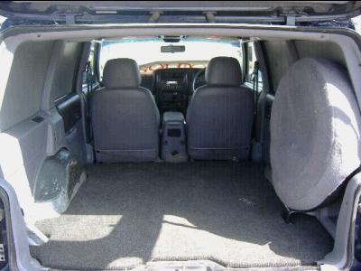

HOrnbrod Posted August 26, 2014 Posted August 26, 2014 Most of the RHD 2-doors went to the UK and Japan. They also made an XJ van (4-door) that was exported to the UK. It was registered for commercial use and qualified for tax breaks. No back seats or rear glass.
