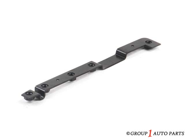

onlyinajeep726 Posted July 24, 2014 Author Share Posted July 24, 2014 Got it removed today. Went fairly smooth, other than having to cut off one bolt and running to the parts store to purchase a T-55 torx drive. Getting ready to install this Class II receiver I pulled off of another XJ. Freshly painted and ready to go. Just need to find or make some nut strips... Link to comment Share on other sites More sharing options...
HOrnbrod Posted July 24, 2014 Share Posted July 24, 2014 http://www.quadratec.com/products/72016_8101.htm Left side: Link to comment Share on other sites More sharing options...
onlyinajeep726 Posted July 24, 2014 Author Share Posted July 24, 2014 I guess I can't make my own very easily... What's up with all those funky bends? Link to comment Share on other sites More sharing options...
fatboyadams Posted July 24, 2014 Share Posted July 24, 2014 I guess I can't make my own very easily... What's up with all those funky bends?To follow the lines of the unibody rails. I got mine from JCR. Link to comment Share on other sites More sharing options...
onlyinajeep726 Posted July 25, 2014 Author Share Posted July 25, 2014 Was looking at the JCR ones, but $50 after shipping is a bit steep for a strip of metal with some nuts welded on... Although, I don't have a metal bender, so making some of my own is likely out of the question. Link to comment Share on other sites More sharing options...

onlyinajeep726 Posted July 25, 2014 Author Share Posted July 25, 2014 Yea, I saw those too. Upon further research, I decided against that method based on people having them rip through the frame rail. Nut strips spread the force of the load more evenly. Plus, no fishing of bolts. Just shove your nuts in and screw it. Link to comment Share on other sites More sharing options...

onlyinajeep726 Posted July 25, 2014 Author Share Posted July 25, 2014 I'm wondering if the've ever been sued for the spacers ripping through the frame? I'd be interested in knowing that too. I guess I'll have to suck it up and buy the JCR ones and call it done. Link to comment Share on other sites More sharing options...
onlyinajeep726 Posted July 25, 2014 Author Share Posted July 25, 2014 I just found the pair of Crown Automotive ones on Amazon with free shipping for ~$33.Does anyone know the size and thread pitch of the bolts I need? Link to comment Share on other sites More sharing options...
HOrnbrod Posted July 25, 2014 Share Posted July 25, 2014 Factory is M12x1.75 x 40. Should be the same with the Crown strips. Link to comment Share on other sites More sharing options...
