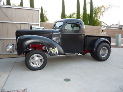

What's Arizona rake? Like this gasser?
Yep. It kind of forces your vehicle to land properly if you catch air while blasting down desert roads. The trick to it working is having a stiff front end and a soft rear, with the shocks to handle it, of course.
