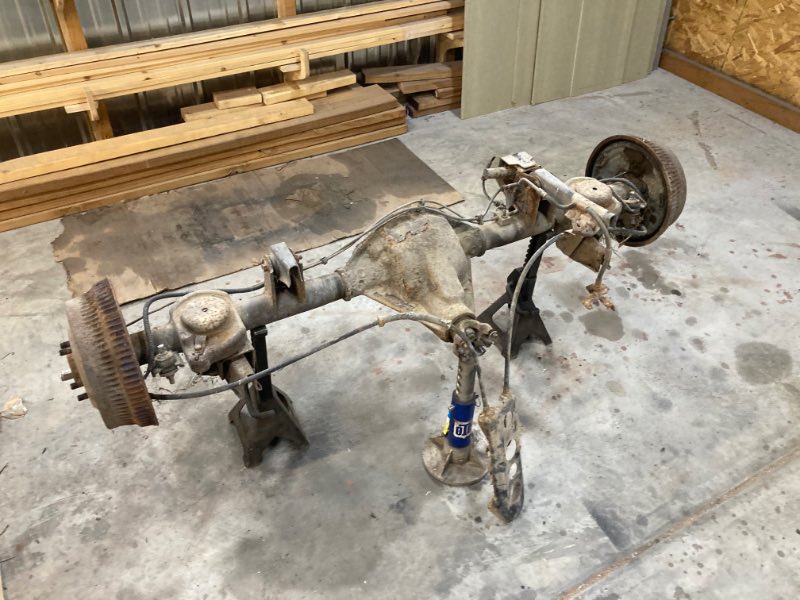

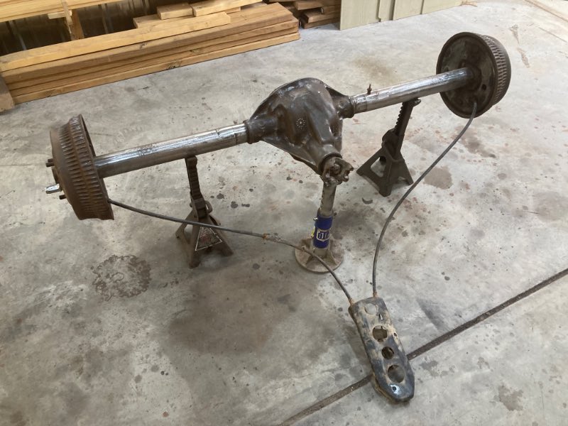

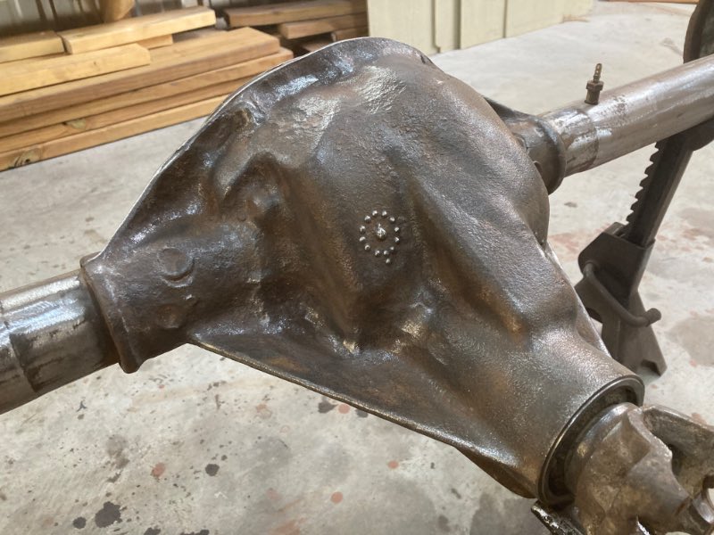

I spent the day cleaning axles. The rear needed all of the brackets cut off, and the front needed some attention too.
Probably the cleanest Dana 35 on the planet right now. As for the 30, the lower control arm mounts needed to get cut off also. One side was booger welded back on while the other was well on its way to falling off.
The story was that the ZJ was a northern rig before it was in Colorado. That checks out with the amount of rust I scaled off and the blown out control arms. Then I popped the cover.
Poor thing has seen some things! The ZJ came with a pile or receipts for the front axle getting rebuilt. Everything looks and feels good, but obviously the old carrier was kept with the new gears.

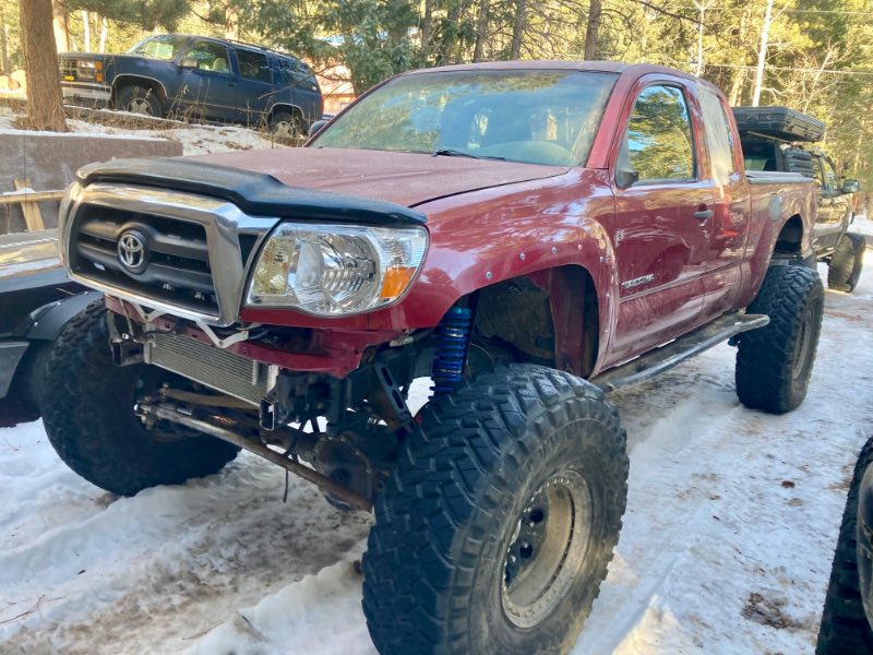

The ZJ came from my buddy’s shop, Pine Metal Fabrication. The Toyota is on tons and 40s. It was originally a 2wd truck and they’re way easier to build into something like this because of the lack of most speed sensors.

I was at my buddy’s shop today so I grabbed more Toyota content. Still an awesome truck but with slightly more body damage than the last time I saw it.
It has a front bumper that currently off of it for repairing the front crossmember.

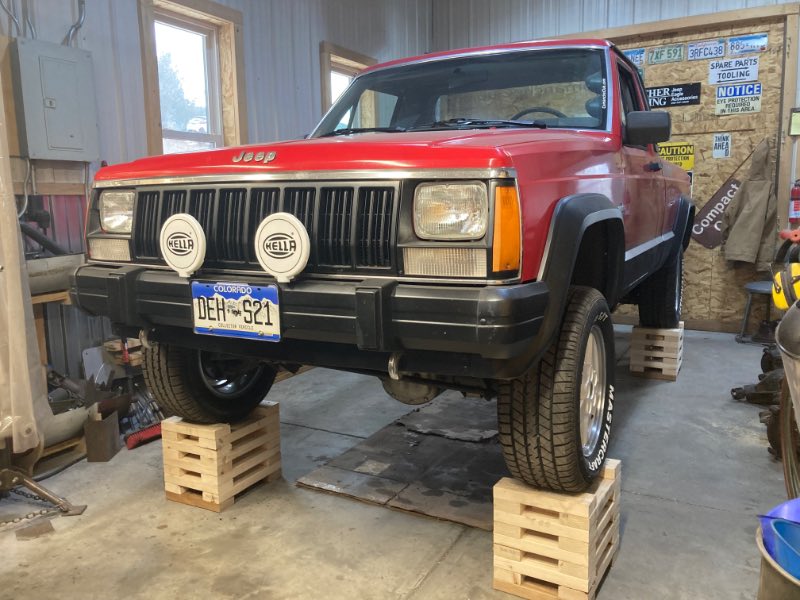

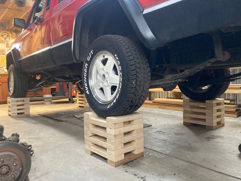

Anyhow… back in street truck land… apparently this is what people with lowered vehicles do?
WAY easier to get a better idea of what’s going on under there.

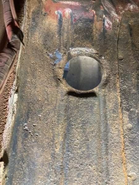

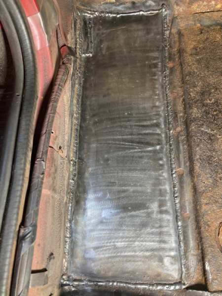

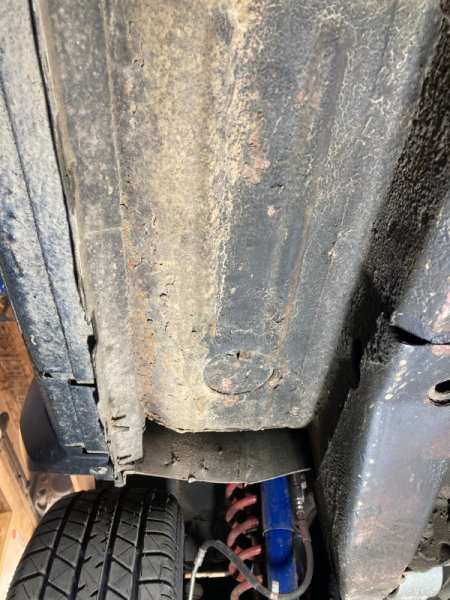

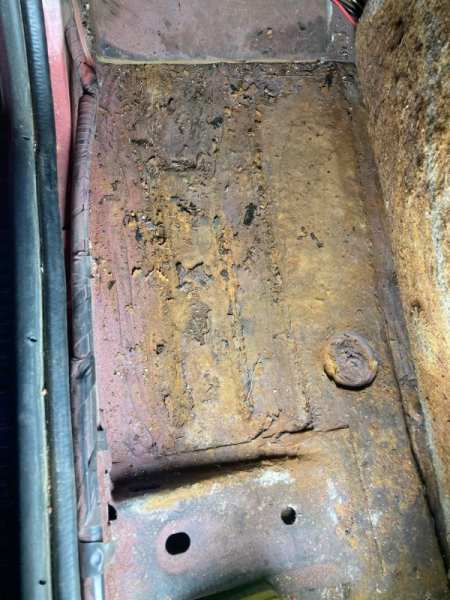

Well, shoot. So… the floor isn’t quite as fresh as it was last I saw it in 2010. I was crawling around under the truck today and noticed the nasty “R” word that never sleeps. :crazy:
I decided to bite the bullet since I was undecided if I wanted to swap to a hand brake lever or go back to the pedal. Truth be told… I never put the parking brake together after the last major makeover in 2010. I like that I can fit a Nalgene bottle in the console, so the pedal went back in. The seat came out. The carpet came up. And then?…
:doh: Oh no! Not quite as bad after some cleanup, but it definitely needs to get cut out.
This was the only Comanche I’ve owned that I hadn’t needed to patch the floor right there. I’ve got a plan but I absolutely despise welding on these trucks.

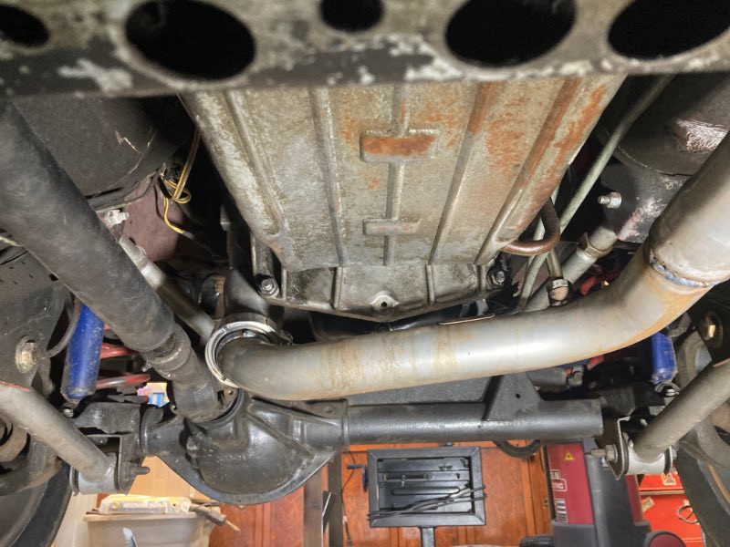

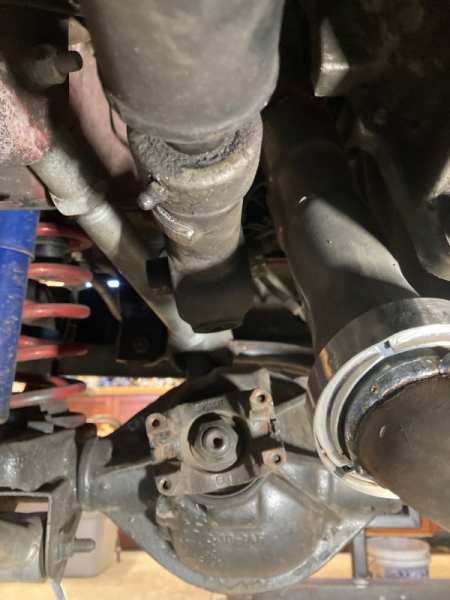

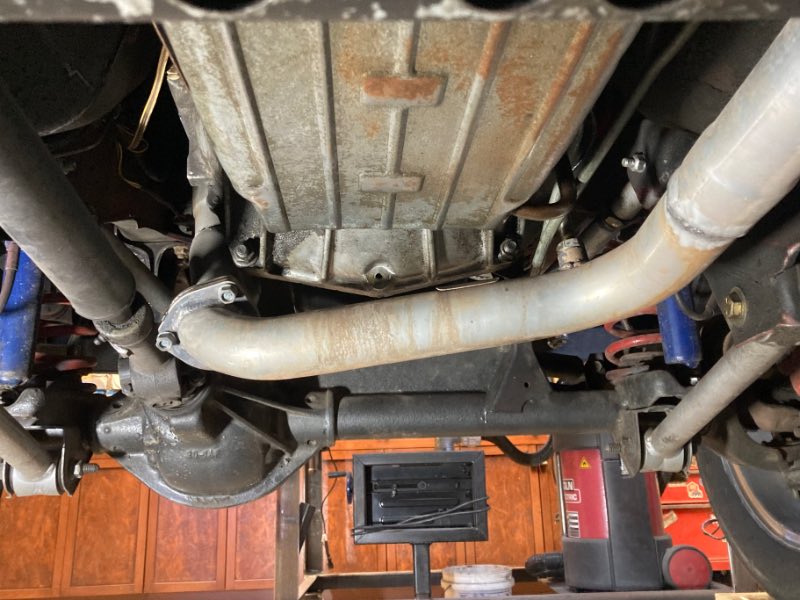

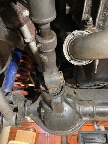

Let’s move on for now. :twak: The exhaust between the header and the transmission cross member has always been an issue also. A while ago I added a flange that turned out to be a huge mistake. I put it in there without thinking about the front driveshaft.
It’s close but only just came in contact with it probably while going around corners. That came out and a v-band went in to make a ton of room.
The angle looks a bit weird, but when you figure where the driveshaft is about to live, the clearance gets better.
Again, tough to see but I can fit a hand around the u-joint and the header. It’s probably fine.

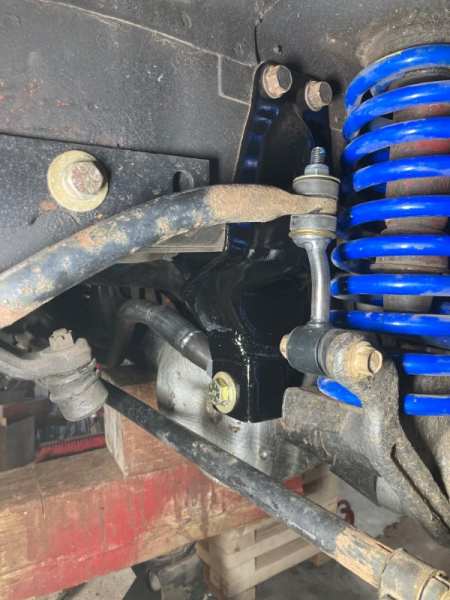

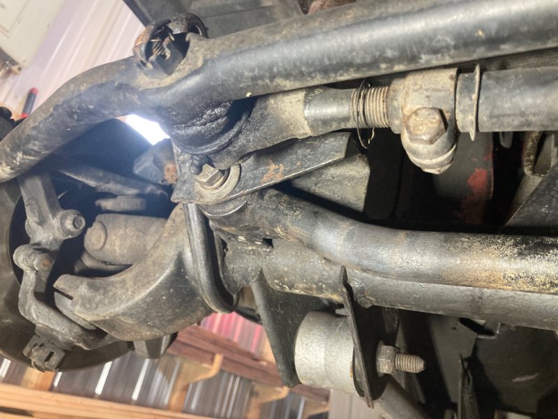

Lastly, I started looking at the rear sway bar from the ZJ. There’s no way it’s going to work. The new plan is to reuse the current front sway bar on the rear. It fits great where I want it to! The bar will get mounted to the axle and I’ll make up some stud brackets that bolt on with the bump stops. Stay tuned.
Floor patch it done.

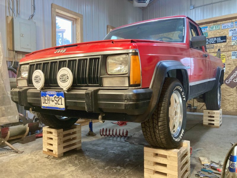

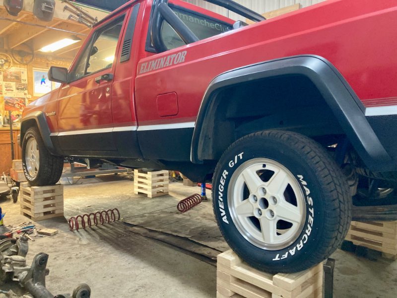

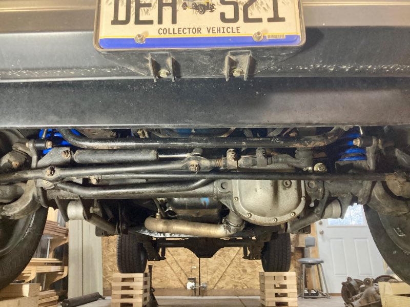

While I’m waiting on brackets I decided to start mocking the new suspension in. I’ve got a track bar to make along with modifying my current control arms. Believe it or not, there’s actually room for the differential to go all the way up to full bump! Granted, not much space, but just enough.

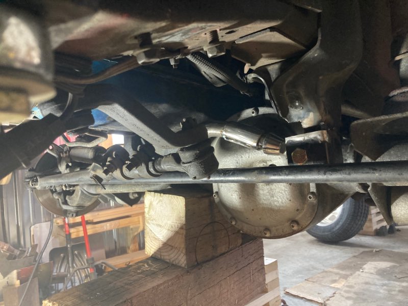

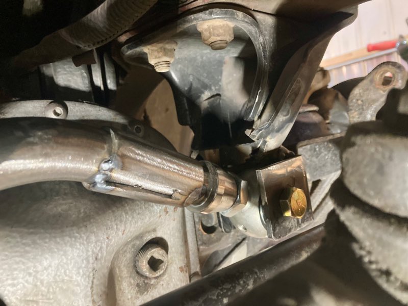

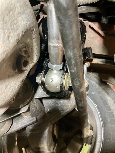

Track bar is mocked up. I started with the stock track bar from the ZJ, bent the bushing side up for better clearance, and then cut the frame side to adapt it to an anti wobble adjustable joint. The frame side bracket got cut and moved around enough to make space for the differential at full bump but also not rearranged so much that it wouldn’t still work with my mystery aftermarket lifted track bar. Again, the idea is to keep everything as swappable as possible should I ever get the urge to change things again… again.
And then I started welding, put one pass around the threaded bung, and it locked up solid. Now I get to cut it apart and order a new joint. :brickwall:
Track bar is done again. :shaking: Everything needing fabrication in the front is done minus the control arms. I’ll be using the current arms but doing away with the flex joints at the frame. Even if the truck were to ever go back up to the lifted height I don’t want the flex joints anymore. They’ve always clunked since day one and added to road noise. I’ll get to them once the axles get swapped.

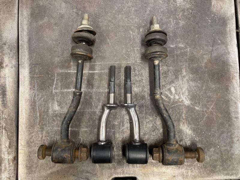

As far as the new height, it can really be seen here… and the lifted links should been another 1.5” longer.
I took a set of stock links and just cut them shorter. The frame side track bar bracket came out and got reinforced and finish welded.

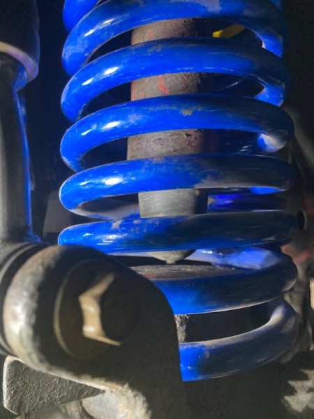

There’s maybe a half inch between the coil seat and the bump stop. I think it’d be great to get it a little lower. Maybe the Archers cut the springs? I remember talking with John and Tommy about the suspensions on the trucks and both of them said that they sat right on the bumps. It’s kind of tough to compare ride height to old pictures because they used all kinds of different tire sizes to cheat the gear ratios for different tracks. There is some space to go lower between the differential and the oil pan… some. I won’t cut these coils, but I do have a set of rear ZJ springs I could play with. It’d mean figuring shorten bump stops too. We’ll see.
As for swapping between lowered to lifted…
… I can do it in about a half an hour. I need to double check caster at each height, and obviously the steering will need adjustment between each height. The longer than stock control arms work out in my favor for clearance at both heights so there won’t be any adjustments there given the caster is acceptable.
