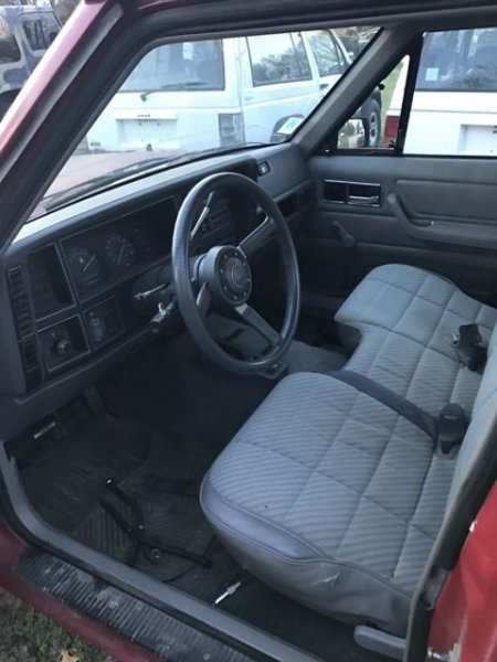

This is where I kind of stalled. As I've got a 73 CJ5 in my garage I'm working on, as well as a 85 XJ, and a 78 XJ waiting in the wings. I really want to get it on the road, so it may be bumped up to the front of the list. It needs as of right now: - A tune up. - Radiator (Possibly going to open cooling system) - Brakes bled, it stops but it feels like Air is in the system, and the "brake" light is lit. -A GOOD cleaning/wax to maybe make it shiny again. -Pull the carpet, and try and figure out a plan for the rust. -Rockers / doors / bedsides and cab corners. (But not really that bad for the Rust belt of Chicagoland it spend it's entire life in.) - A seat, the bench padding is collapsed, and you can feel every wire in the seat. I've got to remember to get the vin next time so I can add it to the registry. -
