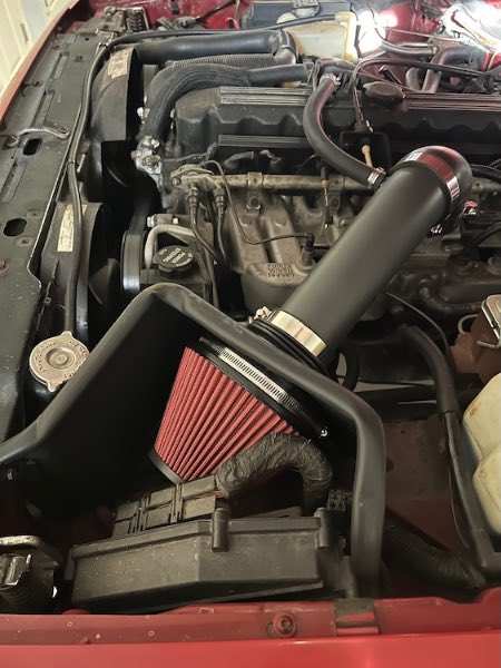

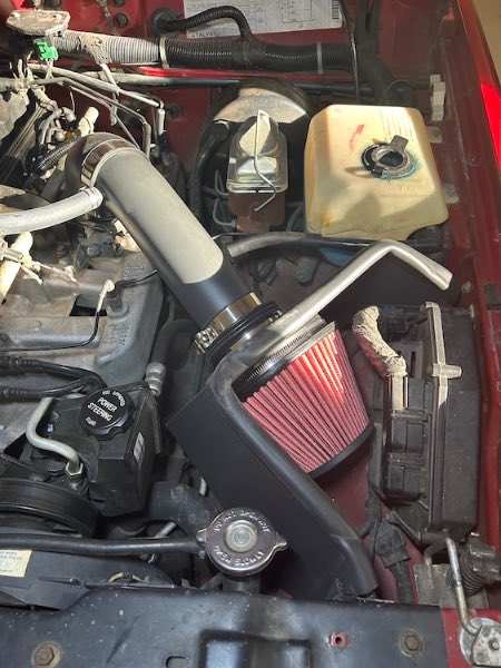

Yes, that's the direction I'm thinking of going. Actually, the CAI has been surprisingly good and does have an air box to a greater degree. It seems the stock box was limiting for air flow which is the main reason I installed it. At the very least, it sounds fantastic. I have no way of determining if it increases power, but my impression is it does, more than I was expecting. Install was a pain because it doesn't fit correctly out of the box and required some hammering on the connection braces, one of which there is no way it will work. But it is solidly anchored in place. I don't plan on going back to the stock box unless this EVAP situation doesn't get resolved properly.

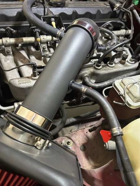

The MJ is running and sounding better than ever with my new Rough Country CAI, but now my EVAP line is venting gas fumes into my engine bay because the CAI did not come with a connection for the EVAP system. I want to avoid gas fumes altogether when it goes in the garage. Should I add a custom connection to the air intake tube or disconnect the EVAP system entirely (if so, how is that done). No inspection here in NC. Thanks everyone.
