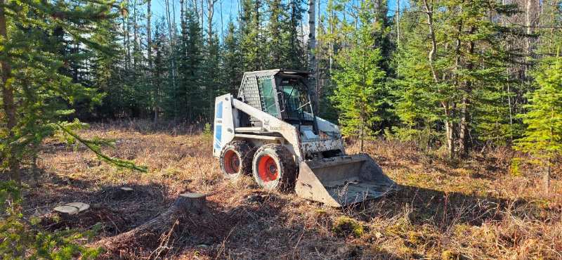

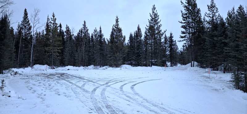

Back in summer/fall I cleared off the access and site.  I used my trusty but terrible 742B (arguably the worst machine Bobcat has ever sold, and man have they sold some bad machines) for lots of this.  I relocated as many of the small trees as I could to other places on the property.

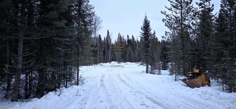

Site in the winter, after the surveyor came out and verified I met setbacks:
It's back pretty far from the house, and the driveway dog legs.  It's what I wanted, not obvious or in your face.

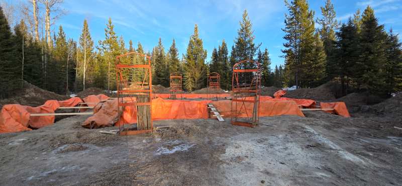

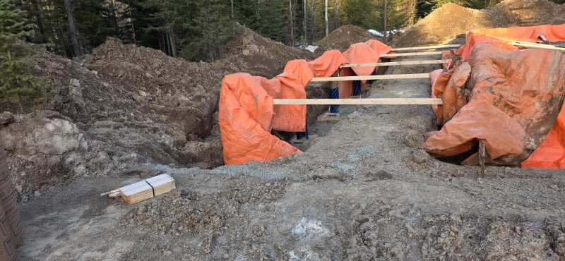

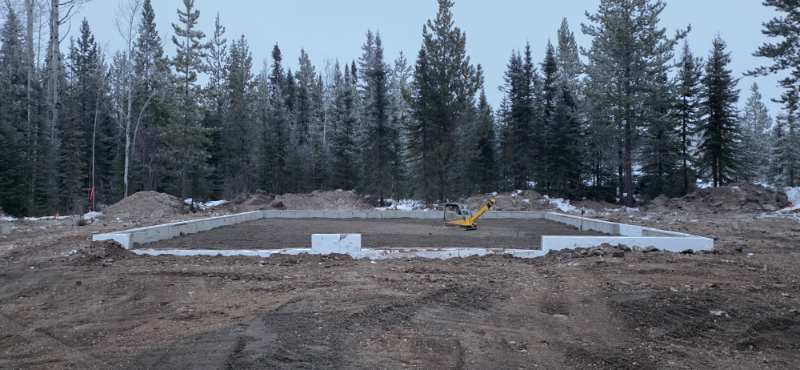

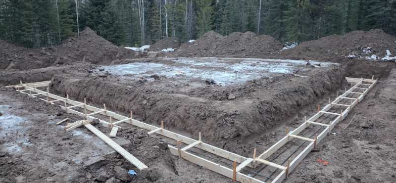

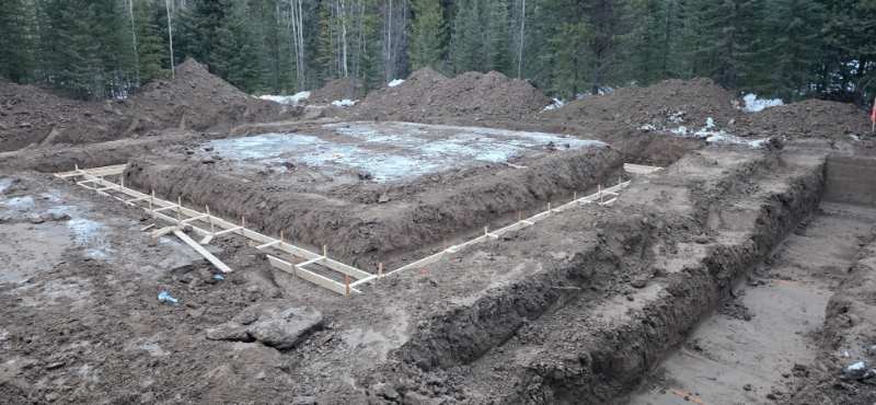

We finally got going with excavation and building forms.  Oddly it warmed up way beyond what was seasonable, which they took advantage of in that they could pour concrete without having to heat it.
The posts for the carports are 5' deep and the rest is only 4'.  It's all clay, and we will have good grading so it should be happy.

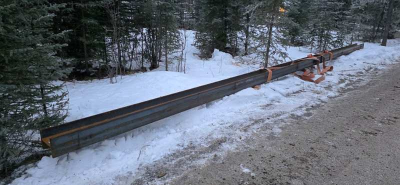

I tracked down a beam for an overhead hoist.  I put one in the last shop and it was invaluable, so I did the same but much beefier this time.  That said, it's still only good for about 2500lbs single point, spanning 40' is asking a lot without getting really expensive.

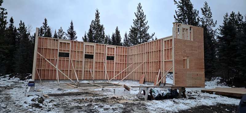

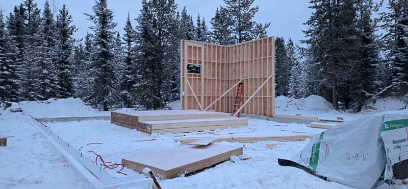

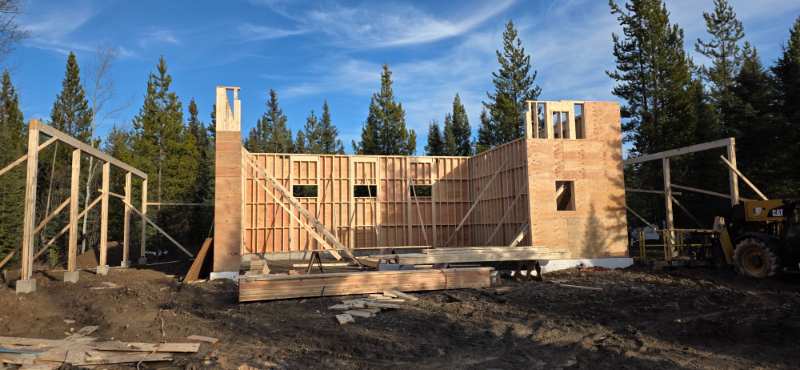

Then it got cold again, but that's fine for framing.  How bloody tall it is going to be started to be apparent.

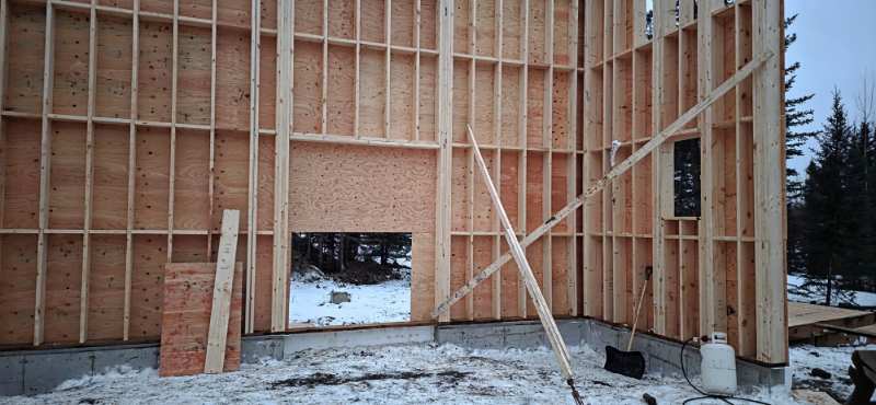

There will be a small washroom, which is what the window is for.  The man door is a french door, and overheight.  I wanted this as in the last shop I put an "oversize" door in for the man door, but I still found I often took large/awkward stuff through it in the winter versus opening the bay doors, so this should work better.
More framing, and carport posts and beams.

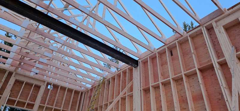

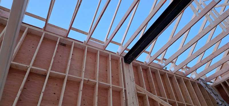

Carport roof framed, and bottom trusses going on (trusses are two piece because the roof pitch is so high).  I went with "spacemaker" trusses because the roof pitch is so high you might as well, it will just be cold storage that is only accessible from outside.
Beam installed.

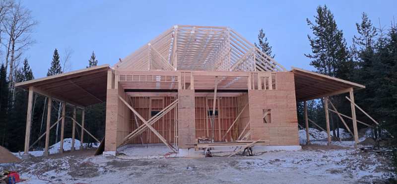

Top trusses on.  It's stupid tall.

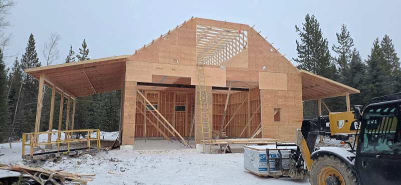

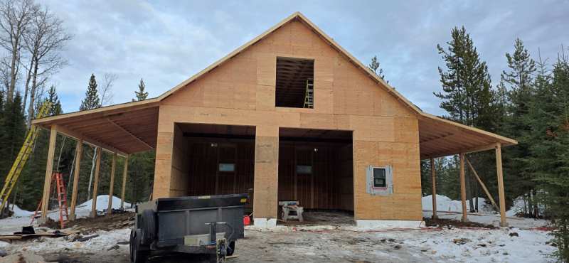

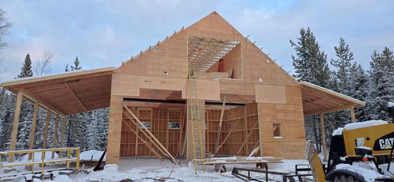

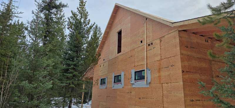

Gables all done, double door framed in for the storage area and the bay doors cut out, windows in.
Back windows in and I got them to put a single door on the back of the storage area.  I will probably put a staircase on the back eventually.  I may pay them to do it but the budget is pretty shot on this honestly, so more likely I'll make something out of steel later.
A big thing I did not consider before this was that to access the storage area, well, it's about 17' to the floor.  I have a Bobcat and a Clark forklift, neither can lift that high.  There will be french doors on the front of it.  I think (pending hearing better ideas) I will probably build a beam/trolly system for a hoist off the front french doors, and normally access it from the back.  If I can find a forklift that can lift that high for the right price I will sell the one I have, but that's somewhat unlikely as 3 stage stuff tends to be more pricey.

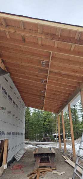

They are picking away at things.   The electrician came by and put fixtures in the carports for lights:

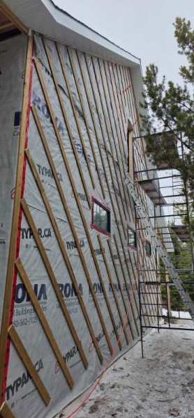

They strapped the back wall:
They're doing a bunch of small things, soffits, flashing, some grading/backfill work, etc.  So they are picking away at it but no big visual progress.
