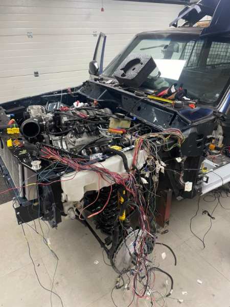

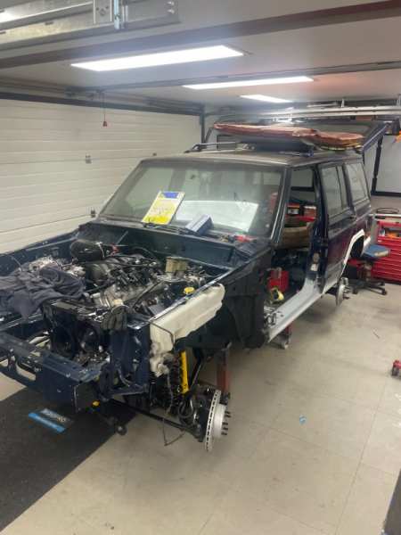

Caspar Posted 3 hours ago Share Posted 3 hours ago Hi, My name is Caspar and I live in Norway, a small country in Scandinavia with only about 6 million people. I am currently rebuilding a Cherokee XJ with an LS engine, and I have also recently acquired a short-bed 4x4 MJ. There are only 14 of them in Norway. I ordered a list from the DMV and called all the owners. The vehicle I bought has been unregistered for five years, so it has to go through a technical inspection before I can register it again. During this inspection, I received a remark stating that the vehicle appears to be equipped with a lift kit. What I am wondering is whether anyone can help me find the stock measurement from the rear leaf spring up to the rubber bump stop on the frame. On my vehicle this distance is 18 cm, which I believe is more than stock. Link to comment Share on other sites More sharing options...
