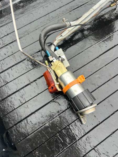

hgeranium Posted November 23, 2025 Author Share Posted November 23, 2025 Goodness. The job is finally all said and done and the Jeep runs great (so far). I took it for about a 15 minute spirited highway drive with no signs of issues. Fuel pressure is also perfectly pinned at 31 at idle and 39 without the FPR. The worst part of that was having to redo the job three times because by the time I got the lock ring back on, one of those quick connectors for the pump slid off (likely due to vibrations from getting the lock ring on) and the fuel pump had no power. So I went through the same song and dance until I finally got so good at it that I pulled it out and reinstalled it in like 15 minutes and got everything buttoned up with no problems. like my previous post, the fuel and the tank is pretty clean and the pump was just missing a strainer. The old fuel filter also still looked good, it was pure clear gasoline that came out with no particles. I bet it was just a matter of the pump that the previous owner put in failing. And thank you to those who helped guide me through this, I don’t think I would’ve had the confidence to do it without you. Link to comment Share on other sites More sharing options...

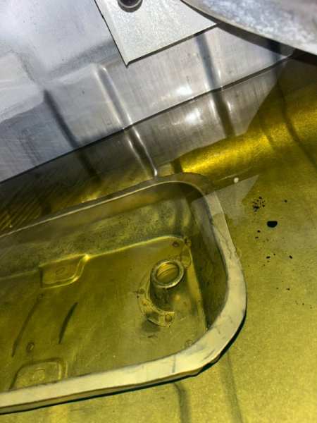

hgeranium Posted November 24, 2025 Author Share Posted November 24, 2025 This job also seemed quite advanced and daunting for my skill level so I'm still happy with myself that I was able to get as much done as I did. I'm pretty good at removing and disassembling/reassembling the fuel pump assembly after doing it so much. Just gotta practice getting lock rings on I suppose lol. Again, this is my first fuel pump EVER, so everything I was doing was brand new. My muffler and driveshaft being right in front of the mounting hole did not make it easier on me. I was having to wrap my arms around my muffler for a sweet embrace to get my hands in the right position to pull the things out and brass punch the lock ring on/off. Just a product of my stubbornness. I want to take the truck to a shop as seldom as possible, so only having to take it in for 1-2 parts right at the end of the job is pretty decent for me. I'll never be the type to give up and take it to a shop before I even try. The only way I'll learn is to actually attempt it. The truck still is very drivable, you just can't fill it up past half a tank, which was too risky for me to take it on a road trip back home. But that new pump is awesome, it's startups are exceptionally smoother and power delivery is fantastic. I can't wait to get it back to full strength and check the fresh MPGs. Thank you @Eagle_SX4for the recommendation on the Bosch. Link to comment Share on other sites More sharing options...
