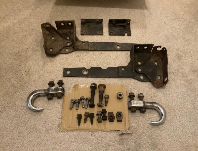

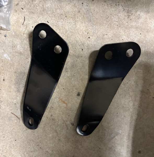

robfg67 Posted November 3, 2025 Share Posted November 3, 2025 Good find, but there is a lot missing there. And to the seller's credit, he is upfront about it. To my eye, those hooks are not factory and the curved pair of braces and a pair of tow eye brackets are missing. Link to comment Share on other sites More sharing options...
fiatslug87 Posted November 4, 2025 Author Share Posted November 4, 2025 Yes, he says most of that but I’ve never seen the tow eye brackets except in the parts catalog. I would love to see a picture of those actual brackets, in place would be even better. Link to comment Share on other sites More sharing options...
Eagle_SX4 Posted November 4, 2025 Share Posted November 4, 2025 As far as I know you could get either the tow eye brackets or the hooks. They are interchangeable and not designed to be used together. Those hooks appear to be original. I pulled the same set off a '87 Cherokee in the junkyard. Link to comment Share on other sites More sharing options...

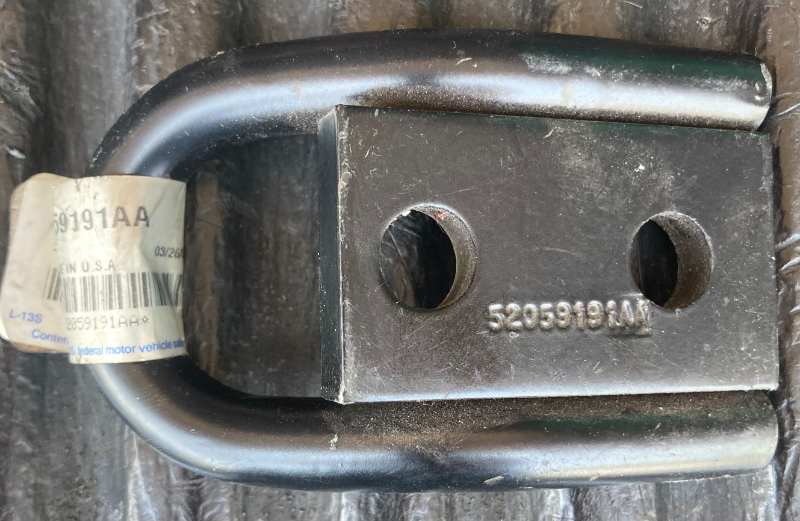

eaglescout526 Posted November 4, 2025 Share Posted November 4, 2025 4 hours ago, robfg67 said: those hooks are not factory They are, you can still get them actually. Warn makes them. 4 hours ago, robfg67 said: pair of tow eye brackets This? Link to comment Share on other sites More sharing options...
fiatslug87 Posted November 4, 2025 Author Share Posted November 4, 2025 @eaglescout526 do you have a picture of the other side? Just interested in the weld on it. Link to comment Share on other sites More sharing options...
eaglescout526 Posted November 4, 2025 Share Posted November 4, 2025 1 hour ago, fiatslug87 said: @eaglescout526 do you have a picture of the other side? Just interested in the weld on it. No...I dont. I sold these about a year ago. Best way I can describe was that its that bar welded to the eye. Link to comment Share on other sites More sharing options...

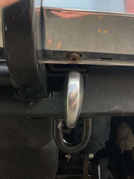

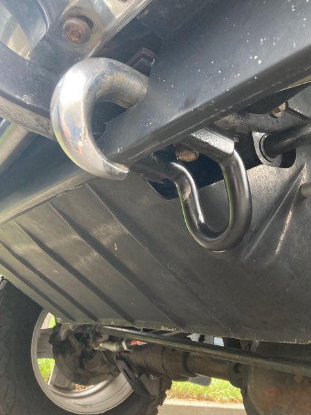

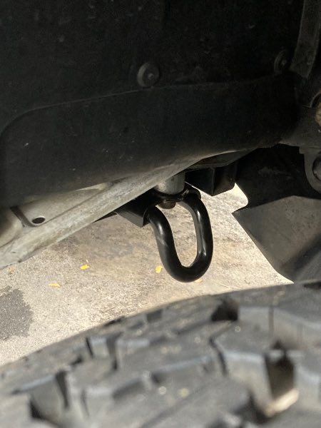

Gjeep Posted November 14, 2025 Share Posted November 14, 2025 Those look to be factory hooks. And these are the brackets that are missing. Uni-body tie-ins to tow hooks. Link to comment Share on other sites More sharing options...
fiatslug87 Posted November 17, 2025 Author Share Posted November 17, 2025 Who says you can’t have tow hooks and tow eyes at the same time? I placed them facing backwards so they would fit. They’re Toyota brackets from FJ Cruisers/4 Runners, the round bar is 3/4” thick. Link to comment Share on other sites More sharing options...
