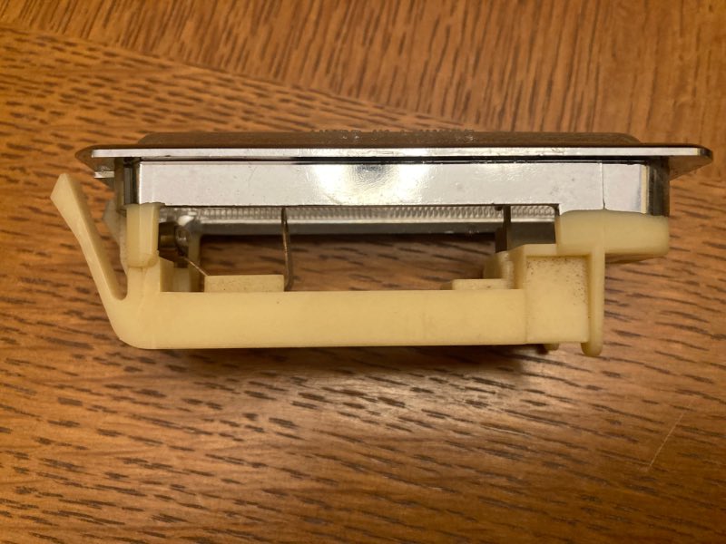

1. How do the assemblies come apart from the B Pillar? Do they just pull/pry out with enough force or does the trim need to come off?

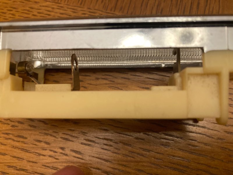

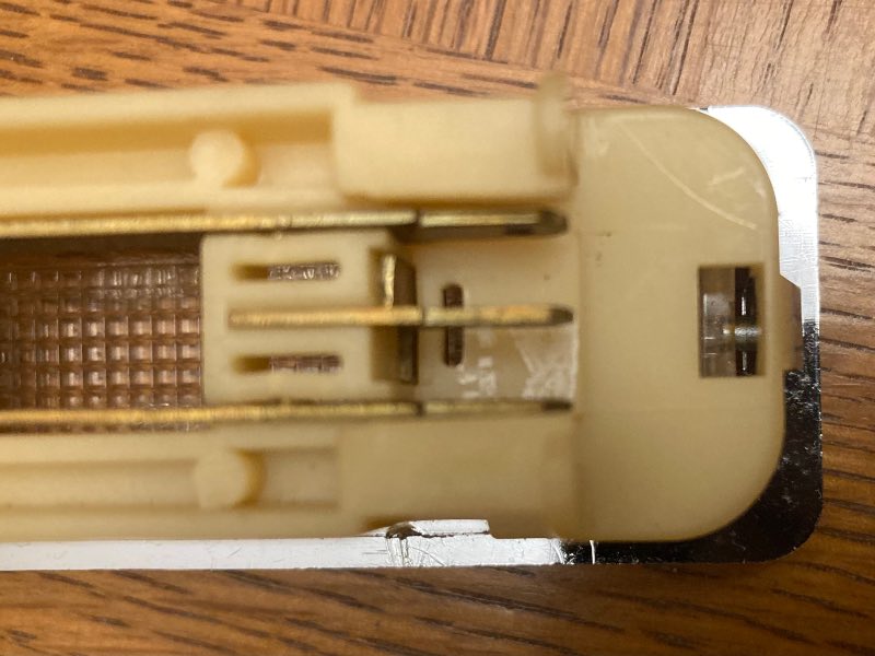

1a. How does the lens itself detach from the assembly? My driver side light works but sometimes needs to be jiggled into the right position to turn on. I want to be able to safely take out the lens to clean the contact points and swap an LED without breaking anything.

1- remove the panel, if you pry the attachment tabs will probably break, see pic 1.
1a- it looks like there may be pins that it slides into, however with 30+ year old parts I wouldn’t try it. You can clean the contacts from the back. see pics 2 & 3.
