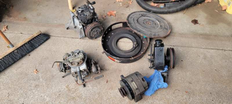

ThatJeepGuy Posted October 13, 2025 Author Share Posted October 13, 2025 1 hour ago, derf said: Yep. It's stupid simple to fix if anything goes wrong. Parts are everywhere. And, if you're ever dealing with going through the mountains, it self tunes as you make big altitude changes. Almost no carburetor can do that (beyond the MC 2150 in the 360 equipped full size Jeeps from 1980-1991). I may actually have one of those carbs sitting on the floor of my garage... The leftover bits from the 83 Cherokee I'm currently LS swapping. Either way I'm getting with the program and seeking a tbi truck then. 18 minutes ago, pizzaman09 said: My experience with one of those was an M1008 Army K30 pickup. Don't get an M1008, the four stroke Detroit Diesel is a sad excuse of a propulsion unit. I'm not much for the Diesel trucks, my buddies give me hell becuase its apparently the smarter move for a hauling rig but I do just a handful of trips a year and primarily in my home state (2hrs drive to the location(s)). I don't see the need for one in my situation, my gasser(s) have served me well enough Link to comment Share on other sites More sharing options...
derf Posted October 13, 2025 Share Posted October 13, 2025 1 hour ago, ThatJeepGuy said: I may actually have one of those carbs sitting on the floor of my garage... The leftover bits from the 83 Cherokee I'm currently LS swapping. Either way I'm getting with the program and seeking a tbi truck then. Yep. Look at the back of that carburetor and you'll see the altitude compensation circuit. Compare it to pictures of a standard 2150 to see the difference. When it's working correctly, it does really well at adjusting the air and fuel flow as you go up in altitude so you don't have to rejet the carburetor. If I were running a carburetor on a small block V8 in a Jeep, that's the one I'd run. But even the most basic GM TBI runs so much better overall. Link to comment Share on other sites More sharing options...
