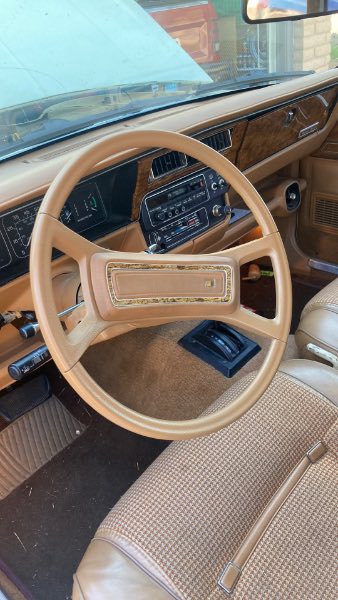

And for your viewing pleasure, the really pristine 140k interior.
